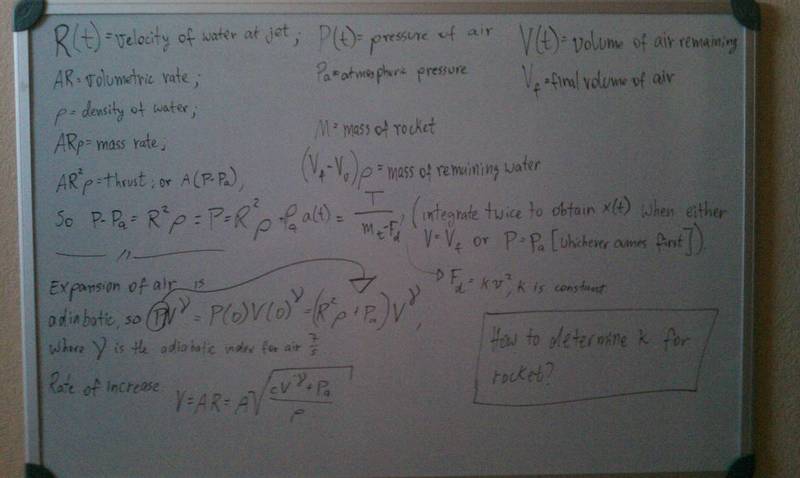

I'm sorry for extending this thread for so long, but I want to understand this.
Okay, well, I never really used spreadsheet for this so I am stuck.
I made the A column from time 0 to 10 in .2 intervals.
And now what?
Attached are the formulae and variables I got from you.
To clear up,
A is the cross-sectional area [itex]\pi[/itex]r2
R is [itex]\sqrt{\frac{cV^{-\gamma}+ Pa}{ρ}}[/itex], what is c?
EDIT: Is the expression ARρ actually [itex]\dot{m}[/itex] = [itex]\int[/itex][itex]\int_{A}[/itex] j[itex]_{m}[/itex]dA where j[itex]_{m}[/itex] is the mass flux and it's a double integral since the surface is curved and not planar?
EDIT 2: Is Torricelli's law useful in this case?

Whoops - I made a mistake here:
should be - Pa:
R is [itex]\sqrt{\frac{cV^{-\gamma}- Pa}{ρ}}[/itex]
c = P(0).V(0)γ
I didn't understand the question about mass flux and double integral. Yes, ARρ is the mass flux through the jet. What curved surface are you thinking of?
Torricelli's law is not relevant, but the more general form, Bernoulli's principle, is.
In fact, it suggests I have another mistake. Where I have
P - Pa = R2
Bernoulli says I'm missing a factor of 2:
2(P - Pa) = R2
I can't see where I went wrong, but deriving it another way does indeed bring in that factor of 2.
As someone else posted, forget about air resistance. It won't matter at the speeds you'll get.
In the attached photo, I see one error in transcription. You may have misinterpreted this:
Rate of increase of V = A.R
I mean that dV/dt = A.R.
One more error: left out -g in the acceleration.
Please see attached spreadsheet. I had to cut it off after relatively few rows to fit in the forum limit, but you can just copy the last row down to cover a longer time period. All units MKS.
Yeah, interpreted the rate of increase as dV/dt.
Okay, so c is the pressure of air at t = 0 times the volume of remaining air at t = 0 to gamma = 1.4? What exactly is c then?
It's the quantity that's preserved in adiabatic expansion. AFAIK, it may be called the adiabatic constant for the process. Not aware of any other name or physical interpretation.
