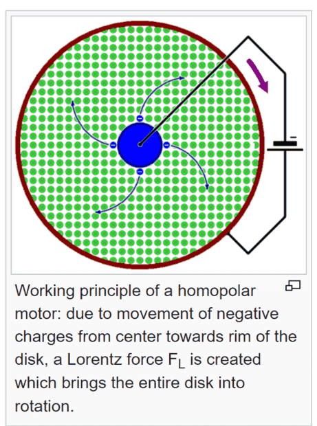

The secret was hidden in the open comments by the video's author. It is a homopolar motor which is explained at Wikipedia.
https://en.wikipedia.org/wiki/Homopolar_motor
Principle of operation​
The homopolar motor is driven by the Lorentz force. A conductor with a current flowing through it when placed in a magnetic field which is perpendicular to the current feels a force in the direction perpendicular to both the magnetic field and the current. This force provides a torque around the axis of rotation.[9] Because the axis of rotation is parallel to the magnetic field, and the opposing magnetic fields do not change polarity, no commutation is required for the conductor to keep turning. This simplicity is most readily achieved with single turn designs, which makes homopolar motors unsuitable for most practical applications.

Are you sure? Honestly the geometry of motors always makes my brain hurt...
The axis of rotation of the OP's coil is orthogonal to the PM B-field and wrt that fixed B-field it changes polarity with each rotation right? The homopolar motors have the H-field from the current sweeping radially, always orthogonal to the B-field (rotationally symmetric). Wouldn't the PM need to be aligned with the axis of rotation for it to be a homopolar version?
OTOH, my asymmetry hypothesis doesn't explain why the OPs motor will start up on it's own. I would expect it to just park somewhere like a step motor.

Not 100% sure, but look at the videos at the bottom of the Wikipedia Homopolar page. One of them looks very similar to the one in the OP.

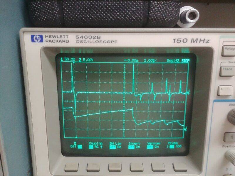

OK, It felt inevitable around post #2 or #3... I had to make a kludge version of one. BTW winding that rotor without magnet wire and coil forms was a PIA.
This thing is mechanically finicky. Sometimes it just moves and parks like a step motor. Often it will oscillate like a pendulum, for longer than I would have expected. Sometimes it starts spinning on its own, but not usually. It works better if the magnet is displaced a bit from the center of the coil, but as it spins it will slowly move the magnet to the center and usually stop (No, I didn't tape/glue it, that would be extra work). The wire I used, based on the OP video was mechanically sketchy as an axel. I think it was AWG#22 or AWG#24. I can pretty much guarantee that that YouTube guy did, like, 27 takes and posted the best one.
@Baluncore wins, it's a "bumpy commutator". This thing acts just like you would expect from a conventional DC motor perspective.
My PS (not a battery) wasn't stiff enough, but I don't have a great desire to fix that, like with a BFC (Big F@#%$#@ Capacitor), I think I'm done here.
This is a trace of when it was spinning like a motor (mine is a crappy motor, BTW). The top trace is current at 0.1A/div the bottom trace is PS voltage at 5V/div.
I guess it's too much to ask the people who make YouTube videos to do some basic instrumentation?
