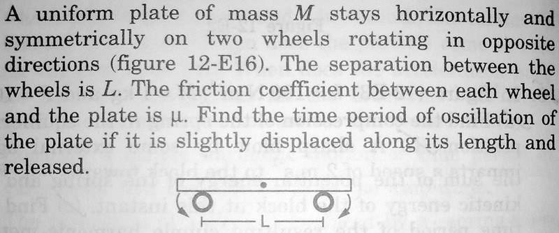

Can a horizontal bar exhibit SHM with rotating wheels?

Please tell me how will there be an SHM?

Maybe the wheels are rotating the the opposite direction than drawn in the picture.
So each wheel would be pushing towards the inside. In this wait an oscillation could arise.
