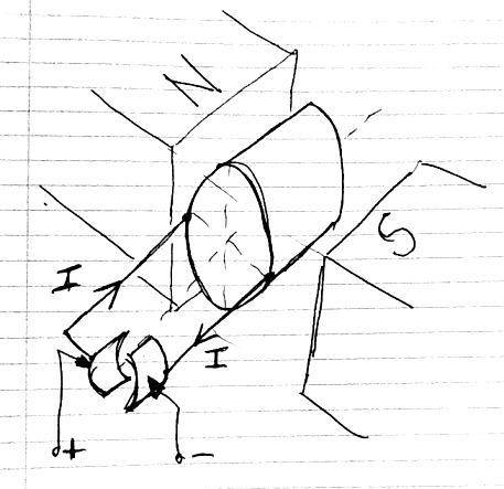

I'm just confused...
I know that magnetic fields can do work only on pure magnetic dipoles like a bar magnet. Based on the formula, the magnetic force on a charge is qv⃗ ×B⃗ which is identically perpendicular to v⃗ and that's why it does no work. However, forces on magnetic dipoles and more general objects don't have the form v⃗ × - they're not perpendicular to v⃗ , so they do work in general.
But still when I look at this picture I get confused:
http://ecommunity.pwsd76.ab.ca/file.php/1030/moddata/resource/23766/physics_30/images/m4/103_dc_motor.jpg
In this picture aren't magnetic force causing the rotation of the loop! Aren't the magnetic forces in a motor on of the key! Factors of motion within it? I mean it makes no sense to me why in this cause magnetic force can't do work on an electric charge... Could someone pelase help me out with this!
The only explanation that can come to my mind is... The electric charge creates a magnetic field and the permanent magnet has already a magnetic filed and thus opposing forces will be apply forces and work will be done by both the electric charged and the magnetic fileld.
As stated by Lorentz law on a current carrying wire: F = IL x B , B = 0 , F = 0 , total work done would equal = zero, simple logic about this matter if you make a small loop and connect it to a battery nothing would happen other then flow of current and a magnetic field is generated by that flow, put a permanent magnet into that state and voila! Motion!

You did not include the internal forces in the wire. The internal forces that keep the wire together are actually doing all the work. The wire loop is acting like a rigid body. Rigid bodies are held together by internal forces. The internal forces in the wire are doing the work, not the magnetic field of the bar magnet.
The rigid loop is doing work on the commutator. The magnetic field isn't doing work on the commutator. Therefore, the "key" forces are the internal forces of that loop of wire. The internal forces both keep the wire rigid and keep the electric charges that carry the current in the wire.
The magnetic field isn't directly causing the torque. The contact forces between the electric current and the rest of the wire is directly causing the torque.
The wire of the loop has two components. One is the free electrons in the wire. The other is atoms of the wire, including both bound electrons and nuclei.
Think of a single conduction electron in the copper wire. The copper wire is initially still in the laboratory frame. The electron initially moves perpendicular to the magnetic field of the bar magnet. The magnetic field causes a force that is perpendicular to the electrons motion. No work is done by the magnetic field, as you said.
The electron can't leave the copper wire. When the wire gets to the edge of the copper wire, it has to slow down. The edge of the copper wire applies a force to the electron which stops it from jumping into the air. One could describe this as a contact force (i.e., a sharp wall). Or maybe one would prefer to think of it as electrostatic attraction of the electron and the positive ions in the copper wire. In any case, a force is applied to the electron by the edge of the wire that slows the electron down.
For every action, there is a reaction (Newton's third law). When the electron nears the edge of the copper wire, it applies a force on the edge that is equal and opposite the force that the edge applies on the electron. Hence the electron is applying a force to the wire.
The force of the electrons on the wire is what causes the torque. The force is not directly caused by the bar magnet. If the electrons were not bound by the wire, then there would be no work done. However, the wire keeps the electrons in place. The forces that keep the electrons in place are not from the bar magnet. The forces that keep the electrons in place have to be accounted for in some way.
You made an identification between the electric charges, the electric current and the wire. The electric charges carry the current. The electric charges that carry the current are only part of the wire. The rest of the wire is necessary to keep the electrons flowing on the path of the wire. The magnetic field of the bar magnet does no work on the electric charges that make up the current.
When your instructor said that magnetic fields can't do work on the current, he was literally correct. However, he did you a bit of a disservice. This type of rule has to be used with caution. The path of the electric current in a wire is constrained by the shape of the wire. Therefore, the forces that keep the electric current in the wire can't be ignored. Constraints imply forces that aren't always explicit in the wording of the problem.
Lesson for engineers: Always take into account the constraints, because the constraints imply internal forces.

Your diagram shows a rigid loop of wire on an axle rotating in a magnetic field. The work is being done by the rigid loop of wire on a wheel that you labelled the commutator.
The internal forces of a rigid body cancel out. The wire, carriers and medium, is rigid. Therefore, you can ignore the internal forces only if you treat the wire as one rigid body. A free carrier in the wire actually has two forces on it: the force of the magnetic field and the force of the medium. So unless you want to analyze the details of the medium, you have to treat the entire wire as a single object. You can't look at the carrier as somehow being isolated from the medium.
If you are asking about the work being done on the commutator, then you should draw the commutator by itself as well as the force vectors that are working on it. If you do so, then you will notice that the magnetic field isn't even touching the commutator. Therefore, the magnetic field can't be doing work on the commutator.
The only force on the commutator is a contact force coming from the rigid loop of wire. The rigid wire contains a substrate and the charge carrier, whatever it is.
If you want to know about the work done on the loop of wire, draw the force diagram of the loop of wire by itself without the magnet and without the commutator. Then draw the forces. There is the force of the magnet on the left side of the wire, the force of the magnet on the right side of the wire, the force of the commutator on the right side of the wire, and the force of the commutator on the left side of the wire.
The rigid loop of wire is at equilibrium. Please note that at equilibrium, the total force on the rigid loop has to be zero and the total torque on the rigid loop has to be zero.
The external forces are the contact forces on the commutator and the force of the magnetic field on the free carrier. As I mentioned, the force of the free carrier on the medium is an internal force. It cancels out the force of the medium on the free carrier. and so can be ignored. Therefore, the strength of the torque (and force) of the commutator has to be equal and opposite in sign to the torque (and force) of the magnetic field.
Your teacher told you that a static magnetic field can't do work on a current. He should have said that the static magnetic field can't do work on a electric charge. However, that doesn't mean that the electric charge can't do work on another electric charge in its vicinity.
What you asked about is the work done on macroscopic systems. Like the wire. Like the commutator. You did not ask what work was done on the charge carrier. However, here is the answer. Work is being done on the charge carrier by the medium that it is embedded in. The charge carrier is being forced by the medium to move in a different direction than it would if only the magnetic field was acting on it. Therefore, the magnetic field is indirectly doing work on the medium.

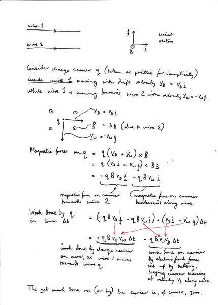

Take the simple case of two parallel wires carrying currents in the same direction. They attract each other. If we allow them to move together, work is done on them (by definition of work). They will acquire KE. This energy will have come from the batteries urging the currents. This is because there is a back-emf due to the wires moving and cutting each others' flux lines.
As the wires move together their charge carriers are experiencing motor effect forces opposing their motion forward through the wire. Extra work has to be supplied by the batteries to maintain the current. This work is 'passed on' as the work done on the wires as they are made to accelerate towards each other.
The force (acting when the wires move towards each other) on the charge carriers in a direction parallel to the wire is made, by the wonders of the Motor Effect (Magnetic Lorentz force) to produce a force at right angles to the wire. It's not really the magnetic field which is doing work. It's a bit like a piece of string going over a quarter of the circumference of a pulley, and so bending through an angle of 90°. If we pull one end of the string, the other end can do work, but it's the puller, not the pulley, that supplies the work.
Here is a simple mathematical treatment of what I was trying to say in my last post.
Good. Consider two wires in parallel with parallel electric currents. Both currents are perpendicular to a static magnetic field.
You are suggesting a calculation of work using the KE and the EMF as intermediate quantities in the calculation. This is an entirely good way to solve the problem. However, the work can be calculated without doing an intermediate calculation of either KE or EMF. The work can be calculated using only the definition of work, the Lorentz force law, and the law of Biot and Savart.
This is more consistent with what the OP is asking. The OP seems to be questioning the consistency between the Lorentz force law and the conservation of energy. Students often learn about the Lorentz force law before they learn about EMF. The calculation of EMF requires one to know about time varying magnetic fields and inertial frames. This should not be absolutely necessary if there is an inertial frame where the magnetic field is static.
Consider the case of two parallel wires with parallel electric currents. The first wire, #1, exerts an attractive force on the second wire, #2, because of the magnetic field the current of #1 generates. The work on wire #2 can be calculated in the inertial frame where the magnetic field is static and homogeneous.
If the force is stationary and homogeneous, then the force time distance where the distance is measured in the direction of motion. If the force is inhomogeneous, an integral is needed. However, for small distances, one can consider the magnetic field effectively homogeneous and stationary.
If there is no motion, then there is no work. This is true regardless of how strong the force of attraction is. I will be more specific. If wire #2 is stationary, the wire #1 can not do any work on wire #2. Zero distance means zero work.
If wire #2 is not moving, then the electric charge carrier is moving in a direction perpendicular to the force created by the magnetic field of wire #1. If wire #2 is not moving, the force exerted by wire #1 can not do work on the charge carrier of wire #2.
You may say that wire #2 must move if wire #1 is acting on it. However, wire #2 can remain stationary if some force other than the magnet is holding it in place. For instance, the wire may be fastened to a wall. The contact force of the wall holds the wire still. Therefore, it is quite possible for wire #1 to do no work on wire #2 even though it exerts a force.
Now, unfasten wire #2 from the wall. Let wire #2 move toward wire #1. Look at the electric charge carrier in wire #2.
The electric charge carrier now has two components of motion instead of one. The electric charge carrier still is moving due to the electric current. However, the electric charge carrier is now being dragged by the rest of the wire #2 toward wire #1. Therefore, the velocity is no longer perpendicular to the force exerted by wire #1.
The is a component of velocity of the charge carrier in the direction of the motion. The force times the distance in the direction of motion is the work exerted on the charge carrier by wire #1.
So the body giving off the magnetic field, wire #1, does work on the charge carrier of wire #2. The magnetic field is doing work, but only if wire #2 is allowed to move.

Darwin123: I'm sorry that I didn't provide my thumbnail (post 13) at the same time as my qualitative (hand-waving) explanation (post 12). I think you'll find that post 13 does pretty much what's needed using just the Lorentz force (magnetic component).
Yes, it does. Your handwritten equations in post 12 are precisely what I meant. I recommend that read that post to anyone who still has a question.
I don't yet know how to get equations and graphics onto my posts. I try to paint a picture with words.
Better yet, I would like to be able to modify the pictures and equations that people send. If all the velocity components on the charge carrier could be drawn into the illustration of the OP, it would be a lot clearer. One extra arrow on the current. showing the extra velocity component, would make the point a lot clearer.

Not the original question but... what would happen if the wire had no edges to keep the 'charge carriers' in.
If the wire loop became a cylinder, as per diagram. Is this an electric motor?
Is work being done?

(1) ILxB is the sum of the qvxB magnetic Lorentz forces on the charge carriers in the wire, and since this force is at right angles to v, it can never do any work on a charge carrier. In a nutshell, vdt.q(vxB) = qdtB.(vxv) =0.
(2) However, as I tried to explain in posts 12 and 13, zero work being done by B on q is consistent with equal quantities of work being done on q and by q. What makes this non-trivial for the current-carrying wire moving at right angles to itself in a magnetic field is that the forces associated with the input work and the output work are at right angles to each other.
In the case of the loop of current-carrying wire turning in the magnetic field, work is done by the carriers on the wire (via essentially electric field forces) enabling the loop to do work via the motor spindle on some external load. Work is done on the carriers by the battery driving the carriers through the coil. [This work is additional to the work done against electrical resistance.] It shows up as the back emf in a motor when running.
Post 13 shows how this comes about, in terms of forces and velocities. The argument applies to any wire in a magnetic field.
