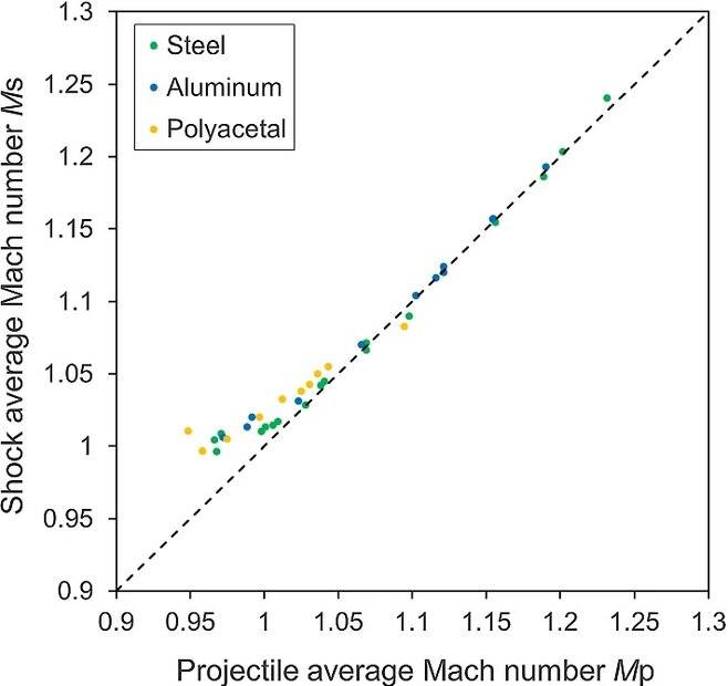

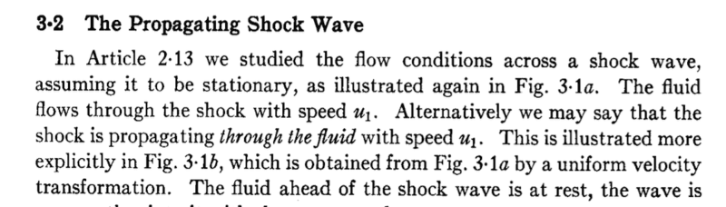

I am going to use ##v## to represent velocities in the lab reference frame and ##u## to represent velocities in the frame of the compression wave ahead of the piston.
Case 1: Impulsively-started piston
Consider first the impulsively started piston. It is initially at rest, and, at some time ##t=0##, it is impulsively accelerated to a velocity of ##v_p## (moving left to right, per the diagram in the original post). No penetration requires that no fluid crosses the face of the piston, so locally at the piston face, the flow is moving with ##v=v_p##, but in the far field it is still moving at ##u = 0##, creating a velocity discontinuity. It is a classical result that such a change in a 1D duct occurs discontinuously, i.e., as a result of a shock. This shock propagates with a speed ##v_s##.
Consider a change in frame of reference such that the coordinate system follows along with the shock, i.e., subtract ##v_s## from everything. Then the velocity upstream of the shock is ##u_1=0-v_s=-v_s## and downstream of the shock is ##u_2 = v_p- v_s##. One of the standard methods for determining the Mach number of a shock is to look at the velocity ratio across it (in its reference frame), which follows the relation
[tex]\dfrac{u_2}{u_1} = \dfrac{2 + (\gamma-1)M_1^2}{(\gamma + 1)M_1^2}[/tex]
or
[tex]\dfrac{v_p- v_s}{-v_s} = \dfrac{v_s-v_p}{v_s} = 1 - \dfrac{v_p}{v_s} = \dfrac{2 + (\gamma-1)M_s^2}{(\gamma + 1)M_s^2}.[/tex]
From there,
[tex]\dfrac{v_p}{v_s} = 1 -\dfrac{2 + (\gamma-1)M_s^2}{(\gamma + 1)M_s^2} = \dfrac{(\gamma + 1)M_s^2 - 2 - (\gamma-1)M_s^2}{(\gamma + 1)M_s^2} = \dfrac{2}{\gamma + 1}\left( \dfrac{M_s^2 - 1}{M_s^2} \right)[/tex]
Note that ##M_s = v_s/a_1## where ##a_1## is the speed of sound in the stagnant air in the tube, so you can eliminate ##v_s## above and end up with
[tex]\boxed{\dfrac{v_p}{a_1} = M_p = \dfrac{2}{\gamma + 1}\left( \dfrac{M_s^2 - 1}{M_s} \right).}[/tex]
Here, ##M=u/a## is the Mach number, ##\gamma## is the ratio of specific heats, and ##a## is the local speed of sound. You can uniquely determine the Mach number of the shock that propagates away from the piston based on the velocity of the piston and the conditions in the tube at the beginning. Indeed, the term ##M_p = v_p/a_1## represents a Mach number for the piston relative to the calm air in the tube (i.e., the lab frame).
You can easily solve the boxed equation for ##M_s## for a given piston Mach number.
[tex]M_s^2 - \left(\dfrac{\gamma + 1}{2}\right)M_p M_s - 1 = 0.[/tex]
That's a straightforward quadratic equation. If you pick a very low piston Mach number, say, ##M_p=0.1##, you still get a supersonic shock Mach number of ##M_s=1.06##.
A fundamental truth about shocks is that they increase the temperature, pressure, and density of the air into which the propagate. Thus, the piston face experiences a pressure greater than ambient even if it moves at constant velocity, and a constant force is required to maintain that constant velocity (assuming the tube is sufficiently long).
If it seems odd that the shock is supersonic, that's likely because the shock Mach number is measured based on its speed relative to the medium into which it is propagating (here, the stagnant air). But the shock is propagating through the heated air behind it, which has a higher temperature and, thus, a higher speed of sound. It is still subsonic relative to that medium.
Case 2: Gradually-started piston
If the piston instead starts very slowly, it will not necessarily immediately generate a shock. A sufficiently slow ramp-up would produce a weak compression wave that will travel upstream at the speed of sound. Of course, that weak compression wave is also weakly heating the flow, thus increasing the sound speed behind it. As the piston slowly accelerates, each new wave front propagates into a medium which is slightly hotter and therefore propagates slightly faster than the wave in front of it. Thus, those waves all eventually (and fairly quickly) coalesce into a shock anyway, and the Mach number of that shock is driven by the final piston velocity when it stops accelerating. So if it accelerates to the same ##v_p## as before into the same medium, the shock will have the same ##M_s## and the problem is effectively identical once you hit steady piston motion
Of course I am trying to paint this picture as a series of discrete waves leaving the face of the piston at some finite time interval but the real process is continuous. You could certainly solve the 1D transient Euler equation to get an exact solution to the real problem, which would have a continuous generation of increasingly fast waves, but I don't think you'd learn much more than the simple thought experiment above.
What is the ramp-up time? It's going to be the same order of magnitude as the time it takes to ramp up the piston velocity since the waves are propagating faster than the piston.
Back to the question of force...
If you know the shock Mach number, ##M_s##, that uniquely determines the pressure ratio across the shock (for a given gas), ##p_2/p_1 = f(M_s,\gamma)##. If you have pressure and area, then you have force.

[1] Liepmann, H. W., Roshko, A.1957. "Elements of gasdynamics." Dover.

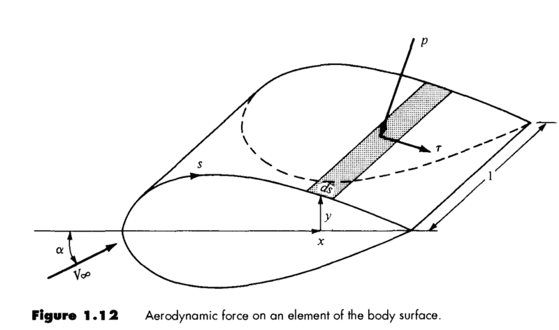

WOW! can you sen me a scan of that page please? email in my Origins doc. How does he explain how the resultant force is away from the surface when the pressure is towards the surface. There's no explanation in Sixth edition.
  • #37

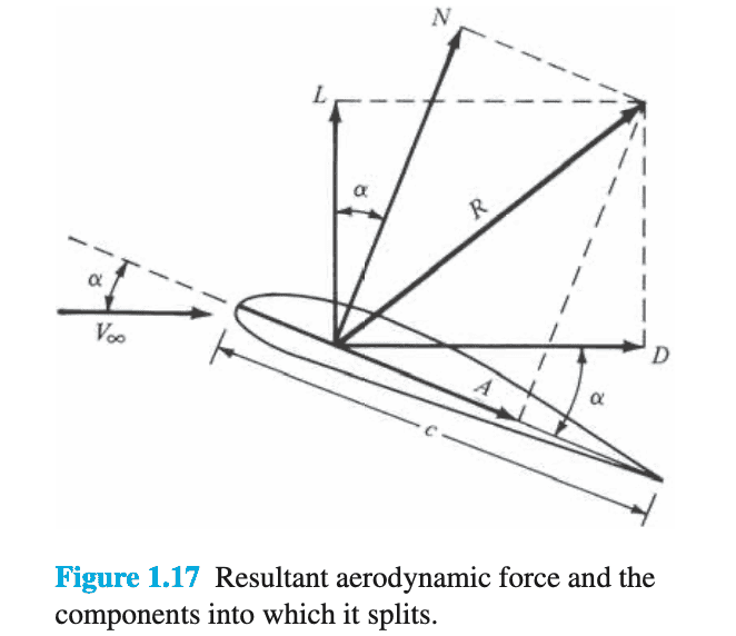

I have just downloaded the Fifth edition of Fundamentals It contains exactly the same error:
Figure 1.14 on p. 20 has the pressure arrow TOWARDS the surface,
Figure 1.18 on p. 22 had the pressure arrow AWAY from the surface.
It is not a typo introduced in Sixth edition. I still doubt Anderson's credibility on this subject.

OK, on closer examination, I concede: you may be correct. In the previous editions the direction of the arrowhead was ambiguous as it was partly obscured by the hatching of the background. It does appear that in tidying up the graphics, the ambiguity of the arrow's direction has been incorrectly resolved in the Sixth edition.
But the fundamental question remains unresolved: How does this pressure on the surface resolve to the resultant aerodynamic force R, shown in Figure 1.17? There is no explanation.
  • #41
The absolute pressure is positive everywhere, so the pressure force always points towards the surface. Air molecules cannot pull at the surface perpendicularly to it.
The resultant force R is the vector sum of all pressure forces, from both sides of the airfoil. If they are greater at the bottom than at the top, R points up.

My point is that Anderson makes no attempt to explain why the pressure, that in all his figures is represented as arrows of equal length pointing towards the surface, is greater at the bottom and lower at the top.
He promises on p. 284:
" Keep in mind that the true physical sources of aerodynamic force on a body are the pressure and shear stress distributions exerted on the surface of the body, as explained in Section 1.5."
But here, in section 1.5, he makes no attempt to explain how the pressure differences arise.
And that's not a slip in the graphical editing of a blurry figure.
Hence my concern about his credibility.

I have spent an hour speed reading Liepman and trying to get a sense of the subject. Having skimmed over pistons in closed cylinders and pipes with varying cross-sections, I arrived at Chapter 3 "One-Dimensional Wave Motion" and thought, "That sounds like my problem" but my brain went pop! when I got to para 4 :
"The fluid flows through the shock with speed ua
What does that even mean?
That's because the explanation is not simple. Conceptually, you can make claims about compression and rarefaction, but that's not the full story. If you want to know how those pressure changes occur and what they are quantitatively, the answer isn't simple anymore. Various concepts throughout that book need to be used together to do the actual aerodynamic analysis of a wing (or sail).
That's a simple change in reference fame. In one, the shock propagates through stationary air with velocity ##u_1##. In the other, you subtract that velocity so the shock is stationary and the flow appears to flow through it with velocity ##u_1##. The later is the most straightforward problem mathematically since you've made it steady.
I have no problem with the pressure wave moving relative to the cylinder. The cylinder is a solid, nonrotating object. In any (inertial) frame of reference, all parts of the cylinder are moving at the same speed.
The air is a compressible fluid - a continuum. All parts of it may be moving at different speeds. The concept of stationary fluid is not so challenging. None of it is moving, no problem. But the speed of a moving, compressible fluid under the influence of a pressure wave is what makes my brain go pop!
Liepman's statement that the fluid flows through the shockwave with speed u1 cannot be allowed to pass unchallenged.
Perhaps "unchallenged" is not quite the best term for you to use in this situation... :wink:
