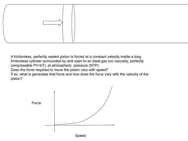

I know that sound travels through air at Mach 1.0.
An ideal piston moving in an open ended cylinder will generate a pressure wave of some sort.
I would like to know how this pressure wave impacts the pressure against the piston.
The answer will assist in working out how the shape and orientation of a sail or wing affects the aerodynamic force being generated by the speed of the foil through the air.
Ref youtu.be/dgE9xhIjTOU and paper linked in vid description

Sailor Al said:
Does the required force vary with speed?
The pressure wave is generated by the change in speed. If you move the piston for a long time at constant speed through a very long open ended cylinder, and there is no viscosity or drag at the walls, then the air will move at the same speed as the piston and the force on the piston will go to zero.
Likes Gleb1964
But here's where I think you're wrong.
At constant speed, since it's a long tube, the piston will be pushing (and pulling) an increasing amount of air. All the air that was in front of of the piston will be moving into the stationary air even further ahead. That air will have to be accelerated to the speed of the piston. Also, the space behind the piston will have to be filled by accelerating the stationary air further behind. Mass x acceleration = force.
I think the force necessary to maintain the piston speed will increase even with a constant velocity piston.
Consider extending that experiment without limit - say a pipe hundreds of miles long that is open at the end.
You are suggesting that it will get harder and harder to push the piston at constant velocity along that pipe. But the inevitable outcome of such a notion is that the stopping force (the pressure), rising without limit as it does, will eventually reach and exceed the force available. Like: you would literally be stopped in your tracks and be unable to push it any farther - first with human strength and, eventually, even with a tractor. You'd be stuck in the tunnel, with your piston, pushed by a tractor, going nowhere ... because of all the air piled up.This is, obviously, an absurd outcome, therefore the premise must be faulty.
I was thinking about a steady state, after a long time at constant speed, where all the air in the tube is moving at the same speed as the piston. With an open tube there would be circulation outside the tube, also at a constant speed.
The speed of the piston affects how long it would take to achieve this steady state. And if it is a significant fraction of the speed of sound, you might not achieve it before you run out of tube.

I would like to break it down: how quickly does the force rise?

OK, If you are having trouble with a long pipe, let's limit it to, say 10,000 Km, with the piston starting in the middle - 5000 Km from each end, and confine the experiment to, say one hour.
Let's set Mach 1.0 to 343 m/sec, so in an hour the pressure front will have travelled 3600*343/1000 Km = 1,235 km. It hasn't reached the end of the tube, so the air in the remaining 3,765 km has not been affected by the piston at either end. So there has been no circulation with the outside air.
How do we calculate the force required then, 1 hour after the start , or 2 hours...?

I did a modeling analysis to describe the transient situation that will exist if the piston suddenly starts moving at a constant velocity. The equation for this will be $$\frac{\partial ^2 u}{\partial t^2}=\gamma \frac{RT_0}{M}\left(\frac{1}{1+\frac{du}{dx}}\right)^{\gamma+1}\frac{\partial ^2 u}{\partial x^2}$$where u is the axial displacement of the air, ##T_0## is the initial temperature of the air in the tube, M is the molecular weight, x is the axial coordinate, and M is the molecular weight. For low piston velocities compared to the speed of sound, this reduces to the ordinary wave equation $$\frac{\partial ^2 u}{\partial t^2}=c^2\frac{\partial ^2 u}{\partial x^2}$$where c is the speed of sound: $$c=\sqrt{\frac{\gamma RT_0}{M}}$$Also, for low velocities of the piston compared to the speed of sound, the magnitude of the pressure disturbance relative to the initial pressure is negligible.
Likes dlgoff, jack action and berkeman
@Chestermiller Can you break that down a bit please, my maths isn't what it used to be.
1) What is the origin of your initial PDE please?
2) What are you using as the function u(x,t)?
3) Why does it rely on a low piston velocity? That wasn't in my problem definition and , while v < c, I would like the solution to allow for a to be a significant fraction of c, like c/2.
4) does your wave equation yield a solution for my problem? Does it give a function of a) force over time or b) force over piston velocity?

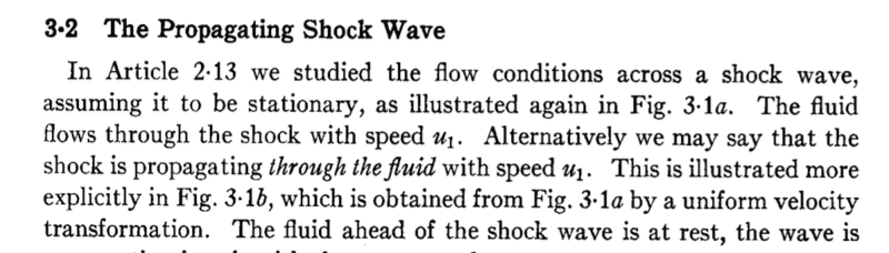

One can make a hand-wavy argument that the scenario is equivalent to the collision of a moving infinite column of air with a stationary piston. If energy is conserved then the result should be an elastic collision with the column of air retreating from the piston at the same speed that it arrived. Shift to the frame in which the air is initially motionless and we have a column of air retreating at twice the speed of the piston.
No speed of sound lurking in this vision.
Of course, the handwave depends on the false assumption that the final state is a column of air in uniform motion. We have an infinite column. Some will be in motion. Some will still be stationary. Forever.
I think that @Chestermiller is on the right track, modelling the situation in terms of an initial disturbance rather than chasing some imagined final steady state.

That's going to take some digesting, many thanks. Case 1 is the one I'm interested in as I am postulating the piston is weightless so can instantaneously accelerate.
I am surprised to find ϒ in the solution. That's a constant for air, right?
Could I trouble you for a worked solution for Case 1 for a piston speed of Mach0.5, piston area 1 m^2 in air at NTP?
And I think you're saying the pressure is constant, correct?
Meanwhile I'll bone on Liepman, Anderson and NASA.

I have deep suspicions about Anderson's credibility. You can see why in the literature review on my paper.
I hope Liepman is more credible.
Meanwhile, I really would appreciate a worked example if you could. Many thanks.

Anderson is fine, and if you have Fundamentals handy (as you seem to based on your link) then it has some good chapters on elementary compressible flow.
The discrepancy to which you allude absolutely can be attributed to a typographical error: I have sitting on my desk right now the 5th edition of said book and the arrow points down in both figures you reference. Some publishing staff member likely just got the direction of the arrow wrong when they prettied up the figure for the new edition. All the equations that follow that figure have the signs correct.
Anderson is by no means perfect, but there's no reason to doubt the credibility of the man's textbooks. They're the de facto standards for teaching introductory aerodynamics in the English-speaking world for a reason.
