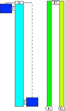

Hypothesis
A contained body of gas that is within a field of gravity will have differing temperature in differing locations within the body. These differing temperatures can be utilised to by a heat engine, to convert heat energy into other forms.
Background
Heat can be described as the disordered vibrations and movements of molecules. Even though it is differentiated from the other forms of energy, it is essentially an unordered form of kinetic energy.
In a gaseous state, molecules are free to move with and against gravity. When they move with gravity they gain more velocity, increasing the contribution of energy that the particular molecule gives as heat energy in that particular location it enters. When they move against gravity they lose velocity, decreasing the contribution of energy that the particular molecule gives as heat energy in the particular location it enters.
This is apparent in everyday live when you consider that it is generally colder in a tall mountain than at sea level as the gas molecules lose heat energy as they move to higher altitudes.
The very important distinction must be made that moving an perfectly insulated contained body of gas to a higher altitude will not cool the gas, as the gas has not been transported to the location by its heat energy, but by mechanical energy applied to the container.
Thought Experiment 1
This hypothesis is best understood when depicted in a thought experiment.
Imagine a very tall structure ascends from a hot desert into the sky, to a point where it is so cold that a bottle of water would freeze at the top. This structure supports an elevator style mechanism that is of the highest efficiency, which lifts a device and drops a device that is exactly the same simultaneously. The result is that if one device is lifted to the top of the structure, the other rests at the bottom in the hot desert.
These devices are large bodies of water that are perfectly insulated, with the addition of reversible heat engine, that when activated will connect the insulated body of water and the outside world.
The device at the top of the structure is at the same temperature as its surroundings and the one at the bottom is at the same temperature as the hot desert. The elevator is activated and the devices swap position. As both bodies of water are insulated they are not the same temperature as their surroundings anymore. The heat engines are activated allowing the heat of the desert to enter the cold body of water and the heat of the other body of water to disperse into high altitude. During this process the heat engines extract the maximum amount of energy from the heat gradients until both bodies are at equilibrium with their surroundings. This process can then be re conducted.
Issue
I assume that the moving of the devices could approach almost 100% efficiency theoretically with the heat engines approaching Carnot efficiency. Based on this assumption, the energy extracted from the heat engines is greater than the loss caused by changing the positions of the sub-devices, this device could perpetuate.
Replacing the atmosphere with a long insulated container of gas. The device would not be able to perpetuate as it would absorb the heat energy from the system reducing it to a point where the device could no longer perpetuate. In this instance however, the system has reduced entropy.
Such an assumption would contradict the second law of thermodynamics.

If I break the hypothesis into two parts:
(a) A contained body of gas that is within a field of gravity will have differing temperature differing locations within the body.
(b)These differing temperatures can be utilised to by heat engine, to convert heat energy into other forms.
Part A appears to be confirmed by the more senior users who have posted.
So two questions remain:
(1) Is part B valid?
(2) Is the hypothesis in violation of the second law of thermodynamics?

Assumptions
(a) different materials (solid, liquid or gas) will vary in the amount by which gravity will form a temperature gradient within the body.
(b) although a temperature gradient forms, heating/cooling a material (solid, liquid or gas) in a given location will result in heating/cooling the entire material.
Thought experiment two
two different materials (solid liquid or gas) are placed into very long pipes. These pipes are insulted with a perfect insulator and are capped at each end by a thermally conductive material. The selection of the two materials placed into the capped pipes is based on the temperature gradient that forms due to being subject to the force of gravity. Pipe X has a material within it that results in the least possible heat gradient forming. Pipe Y has a material that results in the maximum heat gradient forming.
These two pipes have one end capped over the top of the heat conductor a perfect insulator. The pipes are then placed next to each other in a vertical position, with the insulated ends at the top. As at the bottom the two ends of the pipe are conductive to heat, both ends should be in equilibrium (eventually at least) with the external environment at that altitude and with each other at those ends.
At the top, pipe X will be hotter than pipe Y, based on the materials resulting in differing temperature gradients. Now the apparatus has three Carnot heat engines added to it. One connects the two top ends, with the other two, each placed on the bottom end of each pipe. The heat engine at the top would absorb part of the heat energy as it moves across from the top of pipe X to the top of pipe Y, until they reach equilibrium.
The configuration however does not allow equilibrium to be reached. As the top of pipe Y gets hotter, that heat is conducted down to the bottom resulting in the bottom of pipe Y being hotter than the external environment. The reverse occurs for the bottom of pipe X, the top is cooled and heat is conducted from the bottom of pipe X resulting in the pipe being cooler than the external environment. The heat engines at the bottom make use of the gradients formed between the external environment and the bottom ends of the pipe.As the top end moves towards equilibrium it induced disequilibrium between the external environment and the two bottom ends, which in turn moves the top ends back to disequilibrium as the move towards equilibrium. The result is system that can not achieve equilibrium and an apparatus that lowers entropy.
Additional comments
Its best assumed that at least one of the assumptions (highlighted or hidden within) is wrong. Thought experiment one doesn’t rely on assumption A, but on the assumption that the mechanical component of the device used to move the heat engines and sinks could theoretically approach 100% efficiency or at least an efficiency that would result in more energy being harnessed from the device than spent in its mechanical components. My confidence in assumption B is very high.
Also, would a centrifuge, induce a heat gradient?
Feel free to put your two cents worth in (sources would be appreciated).
Iv attached a basic diagram so you can understand these thought experiments. On the left is thought experiment one and on the right is thought experiment two.
Thermodynamics infers to me that a closed system will enter thermal equilibrum eventually, but my vague understanding of the atmosphere contradicts this when i consider that gravity would maintian a heat gradient.
Im only trying to resolve the problems in my understanding, as they result in contradictions.
Can anyone resolve them?

I don't wish to become embroiled in this discussion, however I will attempt to answer the following: Why does a column of gas in a gravitational field not allow extraction of energy in defiance of the conservation of energy where the energy extraction may be considered small compared to the bulk of the gas energy? (Or, please tell me why my perpetual motion concept is right or wrong.)
Bernoulli's Equation helps. This is an equation where the energy of a parcel of gas depends upon its velocity, gravitational potential and pressure. For the problem at hand we don't care about the velocity and consider it zero at any altitude.
We prepare a column of gas in a gravitational field, filling from bottom to top. When filled the pressure is less at the top thus increasing its kinetic energy. The kinetic theory of gasses tells us that the temperature is also lower the higher we go. The velocity of each molecule is, on average, less at the top than the bottom. This is balanced by an increase in gravitational potential energy.
So we put a thermal pile in each end of the column and we can extract energy from the temperature difference.
So what gives? Why isn't this a perpetual motion machine? We can extract energy. And if the thermal piles cause the gas temperature to equalize then we just cycle the gas through a loop to get the temperature gradient back.
If anyone attempts to claim that conduction will eventually even out the temperature this would be thwarted by thermally insulating gas parcels from energy exchange. Who can answer?
The heat engine is shown in the form of wind or water currents. So a fan blade is what we use to "capture" this energy.
One of the guys in the this thread got it right. A tube of gas will eventually equalize its pressure and the heat engine will stop working. The difference in temperature at different altitudes is due to fewer impact events on a system due to fewer particles available at higher altitudes.
You can recreate this effect very easily by taking a tube of gas and putting one half in water and the other in air. There will be a small wind effect until the tube gas equalizes.

These are the kind of heat engines i was considering for the thought experiments, they can be designed to achieve almost Carnot efficiency.
This kind of heat engine allows the gases or liquids to stay static. With only heat conducting into the device to power it.
These are the assumptions that are required to be true for the thought experiments to defy the second law of thermodynamics (I seriously doubt they are true and i want to know what would actually occur, as current understanding suggests that these situations do theoretically defy this law)
Experiment one:
(a) a heat gradient forms within very long static column of gas
(b) heating or cooling any part of the column of gas will result in heating or cooling throughout.
(c) the mechanical devise used to make use of this heat gradient could achieve an efficiency that would allow it to gain more energy than is lost in the process.
Experiment two
(a) a heat gradient may form within matter when subjected to gravity
(b) different forms of matter can result in different forms heat gradients under the same conditions
(c) heating or cooling any part of the matter will result in heating or cooling throughout.
