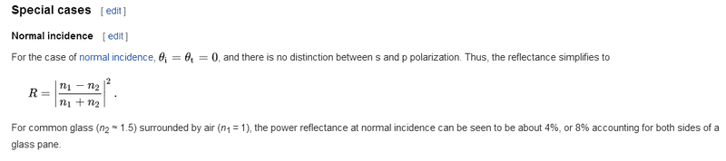

So, when a radiowave strike a surface, whether the wave get reflected or not depend a lot on the characteristic impendence of it. If the radiowave travel from free space to a material. Any mismatch from the approx. 377 ohms impedance of free space (Z0) will result in a reflected wave; the greater the mismatch, the greater the amount reflected. Since conductor such as metal has very low impedance therefore good at reflecting radiowave. But how about insulator?. Could an insulator have the impendence high enough (much higher than free space value) that make it also reflect radiowave?
AFAIK, the ##Z_0## of free space is as high as you can get. You can get lower values of ##Z_0## with different dielectrics that you propagate through.
The value to look at is the refractive index ##n## of the dielectric material, compared to whatever is surrounding it. For a vacuum, ##n=1##, and for water and other dielectrics, ##n>1##. See this Wikipedia page for more information on how to calculate the amount of EM reflected by the interface:
https://en.wikipedia.org/wiki/Fresnel_equations

So in short insulator can still reflect radio wave, just not as good as metal?
Yes insulators are poor reflectors, I think up to 90% of the energy of the incident wave passes through.

And as you can see from the EM reflection equation that I posted from Wikipedia, the DC resistance of a material does not enter into that calculation. Reflection from conductors is governed by other equations, but you were asking about insulators/dielectrics, so that's the question that I addressed.
