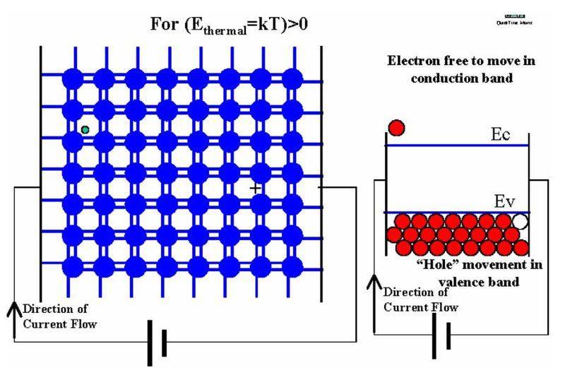

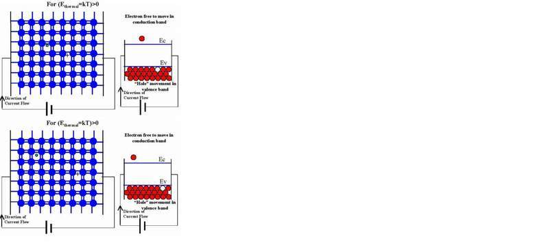

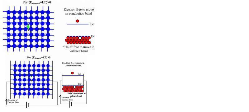

Here is a set of pictures showing the ways electrons and hole move under electric field.
Can anyone tell me how the hole will move after this? I mean that where the hole will move after the final image.

It will get filled with an electron from the wire.
The wire is probably not a semiconductor, it does not have a gap between valence and conductance band and you have a lot of electrons (filled energy states) and a lot of empty energy states to conduct current.
Thanks mfb,
But then the hole will disappear and valence band doesn't have any hole left?
It can't conduct in valence anymore?
Unless you get new excitations: right.
Well, usually you have many electron/hole pairs in the material at the same time, and some new pairs are created all the time. This leads to the (bad) conductivity of pure semiconductors.

Excitation is the process that lead to picture 1: thermal energy, light or whatever kicked an electron out of the valence band into the conduction band.
