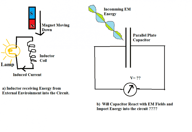

Dynamos and transformers have inductor coils reacting with changing magnetic fields and importing energy into the circuit in form of induced current
1. What about the counterpart of above principle in case of capacitors?
2. Will capacitors interact with electric,magnetic, or EM fields creating emf in the circuit connected ?
3. If so then why we don't have such generators?

Capacitors are mostly self-shielding, so the answer is no AFAIK. Do you see where the E-field is in a capacitor?
If the capacitor terminals form a large closed conductive loop then a changing magnetic field will cause a small AC voltage on the capacitor as an induced AC current flows.
There will be no DC energy received by the capacitor unless something weird happens like the dielectric of the capacitor behaved like a polarised diode material.
hmmm so unlike inductors, the capacitors can never react with EM fields right?

The magnetic field is allowed to move and induce AC current in an inductor.
A capacitor has a fringing field so it can pick up the local electric field, which if repeatedly reversed, would represent an AC electric field across the capacitor.
Both the positive reactance inductor and the negative reactance capacitor will be effected by EM fields that enter into their space. They are scatterers or antennas like everything else. They both receive AC energy.
Without a rectifier, neither will produce DC. The component must be in a circuit.

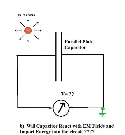

May i try to answer a question with a question ?
What happens if we bring a point charge into proximity of your parallel plate capacitor?
Looks to me like charge will move around in the circuit .
Does location of circuit common (my green symbol) make a difference ? On opposite side from the charge as shown, or on same side(move it to the left side) ?

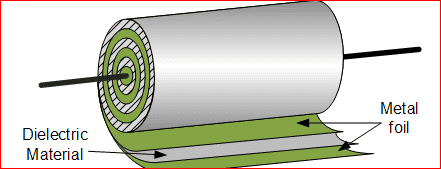

Many parallel plate film capacitors are made by applying a strip of metal foil to both sides of a film dielectric and rolling it up into a tube.
That makes a cylindrical capacitor with one foil on the outside of the cylinder.
Like this.
a real one...
The stripe on left indicates which end is the outside foil.
I believe in placing such capacitors with the outside foil at point in the circuit that's at lowest voltage with respect to circuit common , or chassis ground if you can.
That's so if something rubs through the insulating overwrap it's less of a transient to the circuit.

I believe if you analyze my question above you'll conclude the left hand plate can shield the right hand plate provided it's on the 'grounded' side of the circuit.
Move green ground to left . That holds left plate at zero volts referenced to circuit common so nothing else in the circuit gets perturbed .------------------------------------Oh No, Not Another Boring Anecdote ! ------------------
We had an instrument in the plant with one of those rolled foil capacitors touching the metal instrument cover. After a couple decades of vibration (the turbine shakes everything) it wore a hole through the outer insulation that exposed a tiny piece of the outside foil , smaller than the head of a pin.
It made contact one night shorting the circuit to Earth ground and tripped the plant. Luckily it stayed grounded long enough for us to find it with a voltmeter. It was barely visible to the naked eye .
The other(the inner) foil was connected to chassis ground.
Had the capacitor been soldered in facing the opposite direction nothing would have happened when it shorted because contact would have been to the already grounded outer foil.

In Audio and low-level instrumentation amplifier circuits, the outside foil is connected in the circuit with the lowest impedance to ground. That reduces pickup of hum and extraneous noise.
