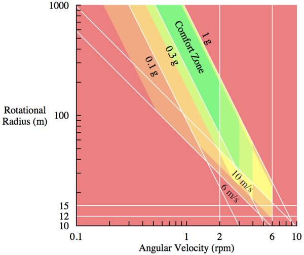

You might want to reconsider those dimensions. Someone standing on the rim of the wheel would experience a significant difference in simulated g force between head and feet and the angular velocity would introduce a noticeable Coriolis effect. Merely moving your arms or head up and down would produce some disconcerting results. Why not consider a much larger diameter wheel and avoid that sort of problem? The sort of rotation rate you are suggesting is much higher than you get when a car or boat turns into a long curve and coriolis is quite noticeable, particularly when trying to move around on a boat during a sharpish 180° turn. People could possibly get used to it, of course.
Your comments about needing to maintain the angular velocity when more load is added are quite right but the adjustment could be quite gradual and a warning could be given if and when a heavy load is taken to the periphery. "Hold onto your hats folks"

As I stated the initial spin probably will be lower, maybe 2 RPM, as full gravity will not be needed during construction. First ring will be for power distribution and storage of raw materials used in the next part of the construction. After around 1200 square meters of solar panels are installed between the three hubs there will be power to charge the batteries of the robots that will be doing the construction tasks. Much gravity will not be needed till construction of the second ring would be complete and I envision that ring to be 150meters. Spin that at 3 RPM would be slightly less than Earth normal. Construction continues with the extension to the final dimension of 1500meters which is about where the book begins. I still need to work out lots of stuff but it sounds like I am in the right spot for help.

It is important to develop an awareness of the difference between things down here and things up there. There's a whole different lot of criteria to be satisfied up there.
Those graphs of the effect of different g environments on the body should be taken with a pinch of salt as there is hardly any serious long term data available (is there actually any?
