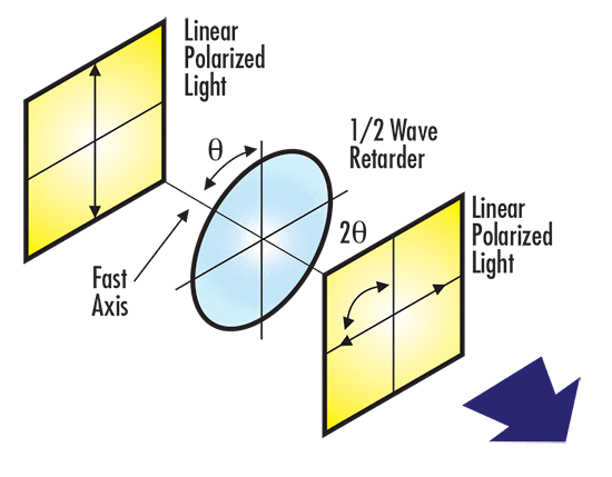

David Byrden said:
...we would create the photon with a known polarisation, and use a series of filters to rotate its polarity gradually. Setting the filters at small angles apart, we can make the probability of absorption arbitrarily small by adding more filters.
Using the technique you describe, you cannot make the probability of absorption arbitrarily small by adding more filters. Obviously, arbitrarily small would include 0 probability. However, you can rotate the polarization state using a wave plate.
