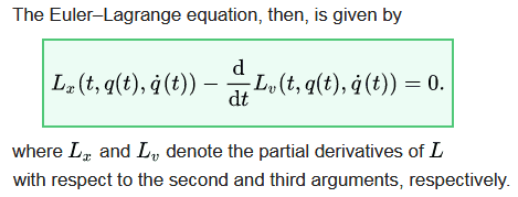

I found the following at
What I think I want to do is first consider L as the integral you said was OK in my post #17. Then I would like to use your suggestion to use a "starting event and initial 4-velocity", but I need a bit of help with that. If I assume the velocity is WRT CC, I want to calculate how the velocity changes as the particle moves to a different position.
One assumption I conjectured (assuming the metric [1]) is that if a particle's velocity WRT CC has a specific value V relative to a specific reference point X, the the particle's velocity WRT CC is also V relative any other reference point. Can you tell me whether or not this conjecture is correct? If it is not, can you explain why or post a reference that explains why?
If the conjecture is correct, can you help me set the boundaries for the integral so that the lower boundary represents the particle's position X0 and velocity V WRT CC, and the upper boundary is another point X1?
Regarding the Euler-Lagrange equation above, in the context of the Integral for L, I assume q = x(t), and q-dot = dx(t)/dt. Is this correct? Or is q = a(t)x(t)?
I would much appreciate any help you can give me.

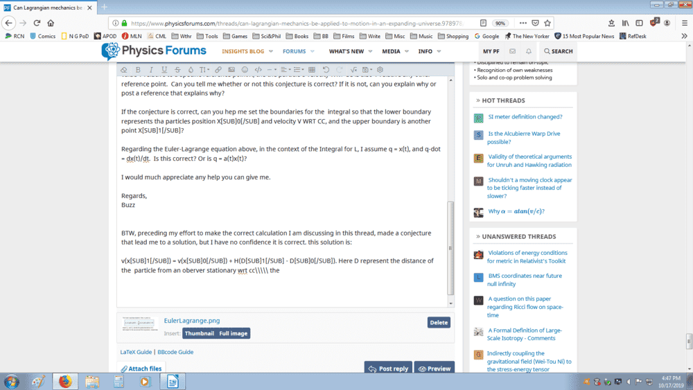

BuzzBTW, preceding my effort to make the correct calculation I am discussing in this thread, I made a conjecture that led me to a solution, but I have no confidence that it is correct. This solution is:
V(x1) = V(x0) + H(D1 - D0).
Here H is the Hubble constant, and D represents the distance of the particle from an observer stationary WRT CC. I am hoping I will either confirm that calculation based on my conjecture is correct, or I will learn why it isn't.
