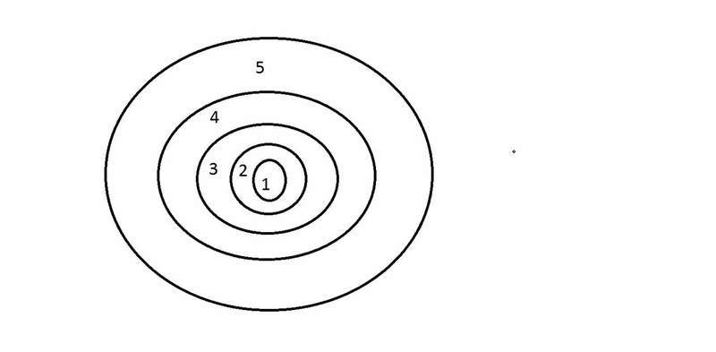

Well forever was meant just theoretically , in real life it could be any given number take let's say 5 spheres as you can see in my attached picture that I made up.
yes because crushing a sphere would be harder than to stretch it from inside and explode it like a balloon.
Now but the smaller spheres would have higher pressure in them but the outer walls of each smaller sphere would be pushed against from the pressure that surrounds it even though smaller.
Now the idea is that you start with say sphere 5 which has a let's say 100A of pressure now sphere 4 has 120 for example it can hold more atmospheres in itself because it is smaller even though from the same material +it is being supported from the outside with a smaller but backpressure.
Now the idea is that as you go to each next smaller sphere the pressure in it would be greater.
Now I have a question what would happen with the outermost largest sphere , even though big, would it feel each pressure of each sphere added together ? Or to say this more clearly isn't the pressures even though separated by a sphere wall adding up a total pressure which is felt by the last wall of the biggest sphere , considering that after that there is normal; air atmospheric pressure but in the spheres there is a pressure that is a lot higher than atmospheric?

The atmosphere of the earth, or that of any planet, models your enclosed spheres. Pressure increases in an inverse relationship to the radius. You could put some thin spheres of material enclosing the Earth at successive increasing distance from the centre and you have something similar to your system.
The Earth atmosphere cpould be considered the infinite system of shells whereby the pressure on the interior surface of a shell equals the pressure on the exterior surface of the shell, whereas in your system there is a definite disrete jump of pressure from one enclosed space to another. The material shell is what maintains the pressure difference by the stress induced upon the shell from the pressure differential.
You may take note that the greater pressure in the innermost shell does not transfer to the outermost shell.
