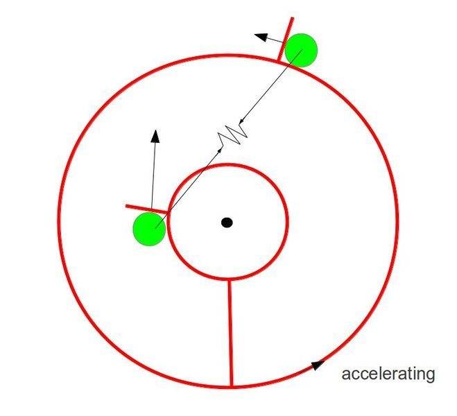

In static I can understand but in dynamic no: accelerate the torus, enough for the wall don't give 100 % of red force at big radius. In this case, torus have a net torque in one direction. If ball at small radius is near center, balls have a net torque in the same direction than torus because acceleration are not the same. I hope it's clear

Nope - same thing - you have neglected some of the reaction forces at the walls of the holes the sphere's sit in.
[edit - you changed these to paddles.]
You keep drawing your diagrams as if the spheres push on the walls without the walls pushing back.
In the case where you have started the system turning - you will have an extra centripetal force to include.
Draw the free-body diagrams for each sphere.
[edit] I see you changed the attachment - but it still makes no difference!
You have still made the same mistake.
If you will not follow advise I cannot help you.

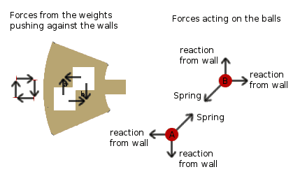

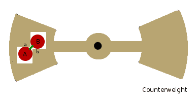

  • #53
Gh778 said:
but sum of force for each ball is 0, and the wall apply counter force to the ball not on itself, I don't understand
The ball pushes on the walls, and the walls push on the ball.
Consider:
The brown part is a solid "rotor" - pivoted about the black dot in the center.
The red balls are sitting in square cavities and are held in place by a spring (green).
The assembly is imagined to be mounted horizontally. I included a counterweight so any rotation will be smooth.
The balls are forced into contact with two walls of their respective cavities.
The force of the contact is equal on both walls.
Ball A pushes on the wall at point a at a greater radius than ball B pushes on the wall at point b.
This means that there is a net torque - so the whole setup should rotate clockwise (and accelerate!)
One can imagine putting a similar arrangement of balls in the "counterweight" to make the machine work better ... in fact, have a whole circle of them! Patents and riches beckon...
But that is an inaccurate picture.
Look at ball A - by itself:
It experiences a force from the spring acting into the corner.
It also experiences the two walls it is touching pushing back.
The sum of all these forces is zero - so ball A cannot go anywhere.
Look at ball B - by itself:
The sum of all these forces is zero - so ball B cannot go anywhere.
If ball B and Ball A are not moving - then the whole contraption has to stay still!
Look at the forces on the walls ... the forces on ball A's cavity, exerted by ball A, add up to the same value as the spring force, and points diagonally. Ball B pushes in exactly the opposite way. So the total force is zero.
Here are the diagrams:
Each object is considered separately - with all the forces included for each one.
Force arrows can be added head-to-tail. I did not draw in the entire brown "rotor".
The mistakes you made were:
(a) neglected the effect of half the forces
(b) added forces that were acting on different bodies
This is why we do free body diagrams.
The only difference that having the contraption spin would make is an extra centripetal force on each ball. This will make a difference to the spring and contact forces but they will all adjust back to zero.
For your next suggestion you must produce free body diagrams if you want the idea to be considered. If you will not do some of the work you are just wasting everyone's time.
If you want to continue to propose more and elaborate devices, you must learn to use conservation of energy more - you may even need to learn to use the principle of least action.

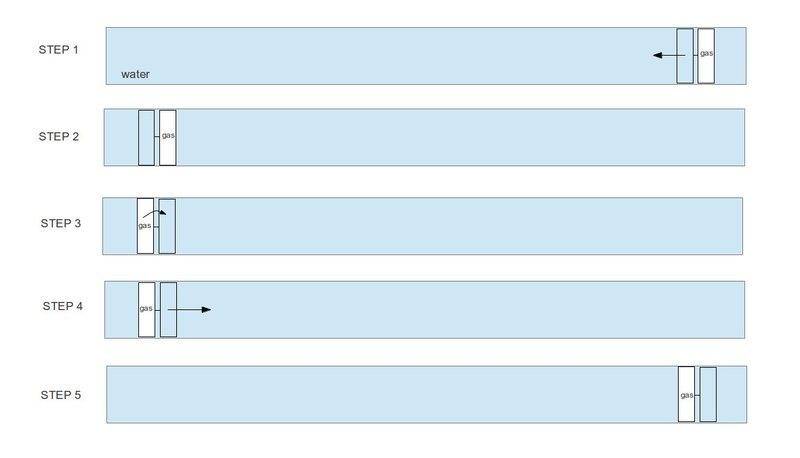

  • #54
Ok, like that I understand, you're a very good teacher Simon ! The best here !
I come back of my first message, with gravitational force. An object composed of half part of water and half part of gas under low pressure. I don't compute gas, I consider like vacuum, it's possible to say the pressure is very low. I consider density the same everywhere. I don't compute temperature. Even there is friction the sum of force on object must be to 0. I computed a very small object in other case, I must wait a long time ! I compute only one layer of atoms between walls and object.
I compute force that attact water due to the lack of water in gas-container and I compute force of pressure due to water inside object on gas-container. Maybe it's not good to thinking like that. For me, I imagine an external fluid which don't attract (weight) and don't give pressure. I put an object in it (half water, half gas). Water-container will change the pressure around the air-container, but gas can't do the same. The net force in this case is the force of buoyancy I compute in program.
I'm not sure my program is good enough:

If the net force is zero in Nature and non-zero in your computer program - then the computer program is wrong.
I refuse to troubleshoot code.
You seem to be thinking in terms of gravity here - you notice that a void (low density part) in a medium acts like a negative mass - as discussed by K^2 earlier.
Note:
You are distracting yourself by attaching the filled box to the unfilled one - it does nothing.
You appear to have failed to account for gravity acting in both (all) directions and the effect of gravity on the fluid is to create a pressure gradient in the fluid. A compressible fluid will also have a density gradient.
The void has a pseudo anti-gravity effect which tends to repel the surrounding denser medium.
(Technically, the dense medium is more attracted to itself than to the low density region.)
The void is in a container - so it does not change volume. This means that a pressure difference builds up between the void and the far ends of the container - both ends. Think of the water as trying to get away from the void, but it is stopped by the ends of the tube.
The effect is the same as a spirit level.
In a closed tube of water with a void in it, the low density box will just move until it reaches the middle of the tube. Equal mass (and, thus, gravity) and pressure from both directions. This is what happens in a spirit level ... the air bubble is the low-density container.
With very low viscosity and no turbulence, the void may oscillate about the equilibrium point if it starts out displaced like you show.
In a torus, the low density container does not do anything.
You can see what happens if you just loop the diagram - every position is the center.
In terms of forces - the pseudo anti-gravity acts in both directions equally, creating a pressure gradient so the highest pressure is diametrically opposite the void.

Or less than 0 for the object to move about and float.
A floating body displaces it's own weight of water so for it to move about within the water it can only be at the maximum the weight of the water it displaces or less than the weight of the water it displaces.
You could argue that the objects moment is different in that it's centre of mass is higher or lower at different points when it's floating around the taurus.If you examine closer though this also cancels out.

When the torus turn, with good rotational speed (good size, small height for object, etc) it can cancel pressure in the fluid, right ? If necessary it's possible to have 2 object diametrycally opposed, like that no specific pressure from liquid.
http://imageshack.us/a/img208/7206/3a0p.jpg
The only pressure around object in it:
- pressure around gas-container = 0 because all is symmetric around it
- pressure around water-container different of 0: force of buoyancy I compute
The object is not attract by gas-container: force of weight I compute, why I find this force bigger ? because it's matrix of particles that attract a matrix of particles. In the buoyancy force it's a matrix that attract only a line of particules. For me, when particles attract particles all forces are canceled by themselves like spring can do. But what's cancel the buoyant force ?
  • #58
You are still distracting yourself with a water-container attached to the gas-container.
Why do you keep doing that? It does nothing.
Do you think that the filled box will be repelled by the voided one (being attracted to the center of mass) - moving away, pulling the gas-container with it?
Wrong - it would add an extra pressure gradient to the fluid.
There is always pressure from the fluid - that is because the fluid has a temperature above absolute zero.
There is pressure everywhere in the fluid.
No - the pressure around the gas container is the pressure of the surrounding fluid.
You mean there is no net pressure difference around the container - so zero force?
Also no true - the rotation forces a pressure gradient, with higher pressure at greater distance from the center of rotation.
The water container has the same density as the water - so it has neutral buoyancy.
What object?
I've been thinking there is a water-filled container next to a gas filled container in a torus filled with water.
In what way?
because it's matrix of particles that attract a matrix of particles. In the buoyancy force it's a matrix that attract only a line of particles. For me, when particles attract particles all forces are canceled by themselves like spring can do. But what's cancel the buoyant force ?
Remember - the buoyant force comes from a pressure gradient ... in the spinning torus, the pressure is greater along the outside than it is along the inside, so the net force on anything floating in it will point inwards. This is an unbalanced force - which is expected because the system is accelerating.
