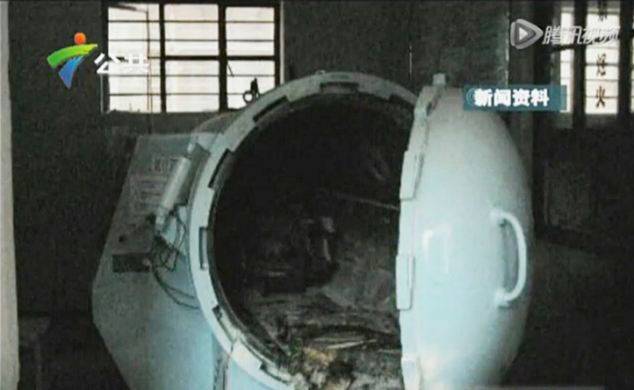

I have a cylindrical pressure chamber with approximately 80 cm in diameter and the length of 1.5 m and metal wall 1 cm in thickness. I know most pressure chamber have circular curved door on it, like this one for instance.
I was wondering if I can put flat circular door on the chamber (because curved circular door are difficult and expensive to make). Can I put 8 bar of pressure to it? Could it withstand the pressure? And what is best suggestion on this pressure chamber?

Answer in principle is that yes you could but probably not a good idea .
It would have to be much thicker and the practical difficulties of design , manufacture , installation , test and certification may cost a lot more than just using the existing dome end door .
Pressure vessels are subject to stringent design and test regulations . If you actually decide to pursue this change then you would need to employ a qualified professional engineer with extensive experience of pressure vessels .

you can use a flat door, just add ribs on the outside to keep the door flat when the chamber is pressurized. but as noted, pressurized tubes can be dangerous. 8bar is ~116lb/sq.in. (116psi), let's say that flat door is 20sq.ft, that's 20x144=2880sq.in, and force would be 0.334x10^6 lbs pushing on that door face. 1/3 million lbs !
keeping a flat door sealed is also a challenge.

nobody gave any designs to use. litigation? the OP would have to get the design. a flat door that is 2" thick steel will work, be very darn heavy though. 3/8" steel with lots of ribs will also work, but also a pita to make. concave doors allows for material savings while at the same time will work.
and yes, its rather ez to calc the potential joules in 8bar tube of Xcu.ft. of std air.
The Physics Forums do not allow discussing dangerous activities, and modifying the design of an cubic-meter-sized 8-bar pressure chamber is such an activity. This thread is closed; we cannot improve on Nidum's answer above:
