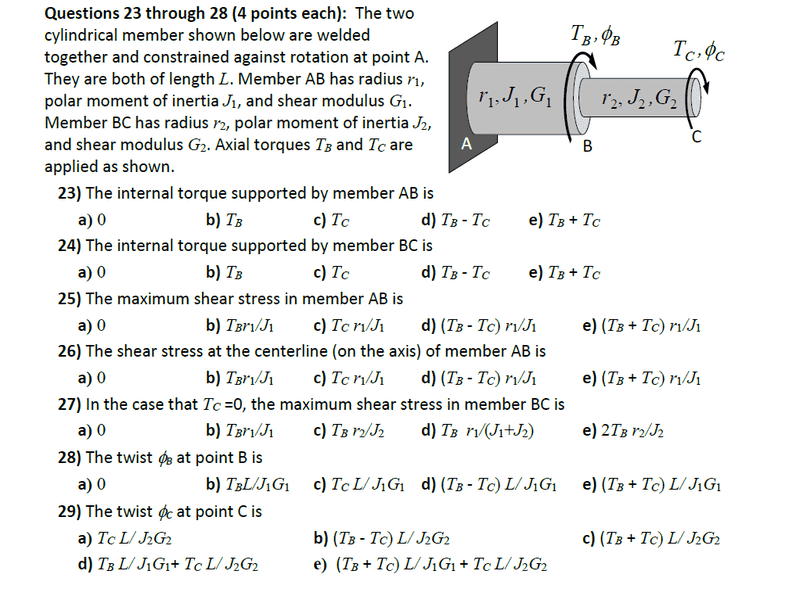

Can someone confirm my answers on a few torsion problems?

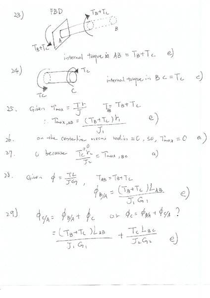

I feel I did something wrong, but not sure where is my problem. I don't feel conformable on number 26 and 27 and 29, can someone please tell me which answer is incorrect and any tip on solving it would be greatly appreciated!

Well you better start feeling comfortable because you got them all correct! Nice work.

wow, I was expecting at least one incorrect answer, thank you for checking my work!
