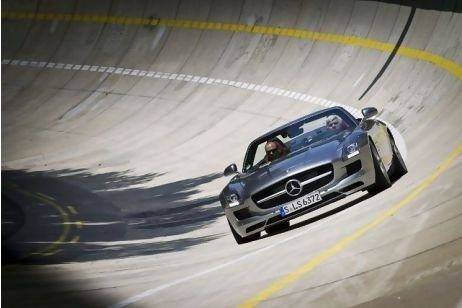

Have you wondered why curves on highways and race tracks are steeper on one side than the other? (image of curved slope on bank test track) .
In NASCAR, most (if not all) of the banked tracks have a constant slope angle on banked turns for the main driven part of the track, with a curved transition on the inner, normally non-driven part of the track.
