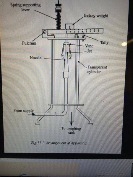

We need that image to understand what the problem is . Did you use the UPLOAD button bottom right of reply box ?

There you go that's the overall set up and the jockey part

I don't see in the problem statement the requirement to calculate the change in momentum, only the forces resulting from it for each case and then plotting those forces. Below is a sample of an experiment essentially identical to yours and equation 4.5 is what relates the impact force to the fluid momentum.
Unless your test measurements indicate that the flow rates for the flat plate are lower than those for the hemisphere for identical jockey weight positions I think this should help resolve your problem.
http://web.cecs.pdx.edu/~gerry/class/EAS361/lab/pdf/lab4_impactOfJet.pdf

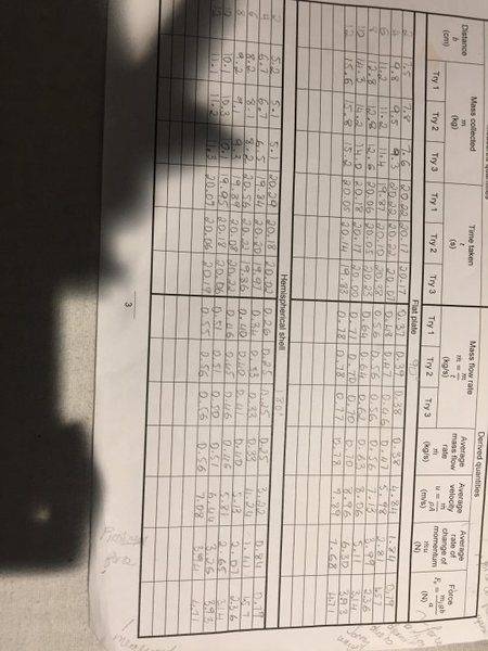

What I don't understand is that it says that the force acting on the fluid for the hemispherical she'll should be twice that of the plate so (2mu) but the results I got shows the inverse the force acting in the flat plate (mu) are twice the one acting on the hemispherical plate and like I said I checked with some classmates and they got the same pattern I have attached the first page of the report and my results

Your posted data results page is basically not readable you might try photographing 90° from what you used and that may help but a simple plot of flow rate vs calculated force would be much easier to review.
If I understand what you are saying, your test results indicate that for the same jockey weight the flow rate for the hemisphere is twice that as for the flat plate.
This morning I managed, with a bit more effort, to review the data sheet you posted and the the sheet shows that the fluid flow and therefore the momentum of the fluid flow for a given jockey position is lower for the hemisphere than for the flat plate, which is exactly how it should be because (as per the equation I referred you to indicates) the reaction force for a given fluid momentum is greater for the hemisphere than for for the flat plate.
