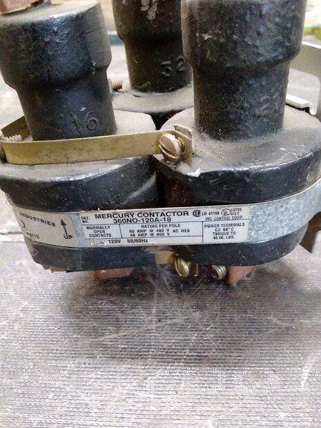

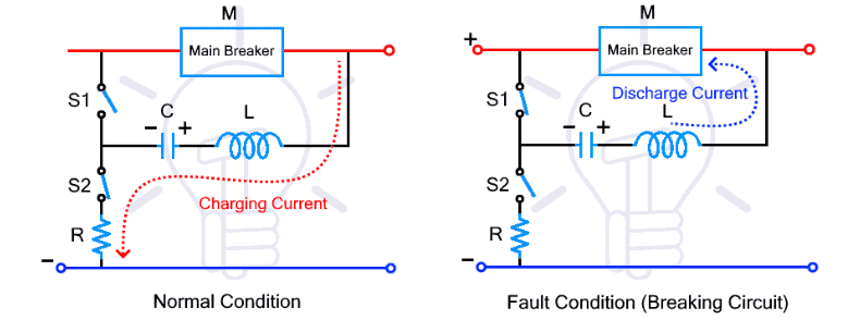

If you think mechanical silver contacts will arc weld them self together then try mercury contacts. I have worked in industry 40 years, I have used mercury contacts for very high amp circuits they are impossible to arc weld the contacts. I used 3 of these on a 480 volt 300 amp 3 phase electric furnace once it ran good for 20 years almost zero maintenance. Fuji temperature controllers cycle on/off all day to keep oven temperature differential accurate to 5°F. The most common Mercury contactors on/off voltage is 120 volts AC but you can buy these in many voltages. They also some as, single contactor, double contactor and triple contactors. You can buy 300 amp triple contactors connect them in parallel to get 900 amp contactors. You can use mercury contactors to turn spot welder on/off. Notices picture #2 shows the 3 phase contactor rated 60 amps, put all 3 in parallel you get 180 amps.
There are a lot of mercury contactors for sale on ebay, I did not look at every one for them but the ones I looked at all have a control voltage of 120 vac. The contact voltage can be any voltage you like up to 600 volts. Most common contact voltage rating is 480 volts it will work good for your 30 volts. I have seen max ratings of 240v, 480v & 600v. Do ebay search for Mercery Contactor I found about 20 of them. You can also buy new contactors from any industrial electric supply.
I just now noticed picture 2 shows 3 contactors are already connected in parallel for 360 amps.

I don't really know mercury contacts, but in general switching high current AC and DC is really different beasts.
A small cut from a random* relay datasheet:
600V AC relay is rated only for 60V DC. ...
Some manufacturers specify the guaranteed cycle number instead, which is usually 'plenty' for AC and 'few' for DC with similar current/voltage. ...
So, motor starters and other industrial AC stuff are absolutely decent stuff, but without detailed and careful considerations they cannot be recommended for DC applications.
Generally, it's the best if high current DC can be done without any contacts at all.
(*) well, not that random: I had to dig through a dozen datasheets till I could find one rated for both AC and DC... :doh:

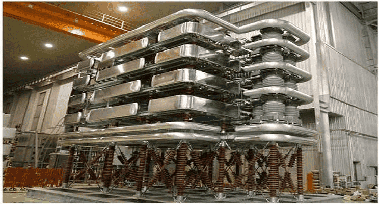

The discussion made me wonder about circuit breakers used for HVDC power transmission. The are used to break 100 kA at voltages more than 1 MV.
They use extra snubber circuits as mentioned earlier to force zero current in the main breaker at the moment of opening. Here is one variation.
But the sizes of the breakers are impressive.

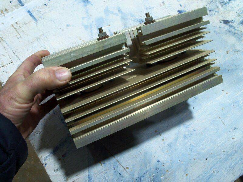

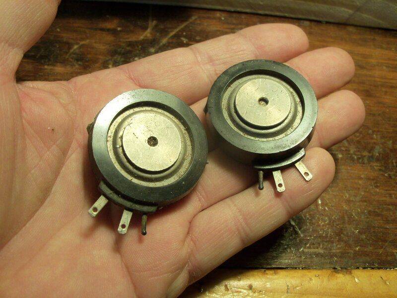

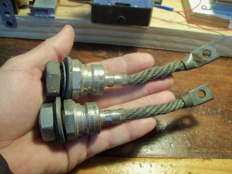

We live in a town with a large industrial park with about 200 factories. We also have a scrap yard where industry throw out old used equipment. Every day after work I stopped at the scrap yard for 5 minutes on my way home. You will not believe all the things I bought from the scrap yard. Industrial electronics is fun to play with.
The diodes in my hand are 800 amp 600 volt pancake diodes. The 2 connectors on the side of each pancake diode are the trigger. Pancake diodes probably came from a spot welder. After spot welder closes and clamps down on metal parts then it fired the diodes to do the spot weld. The aluminum heat sink weights 16 lbs each.
The 2 antique diodes in my hand are rated 350 volts 300 amps. I use to have diodes like these with trigger wires I forgot correct name, I think they were called, triacs. Someone in another country wanted the triacs so I sold them. I built a nice 12 volt car battery charger on wheels with the 350 amp diodes its 12v 60a its a good jump starter for dead battery. Industrial parts are bullet proof you need to try very hard to destroy them.
