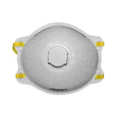

What is your comment about n95 with exhalation valve? It is supposed to suck out carbon dioxide.
How about one with fan built in? Do you think it has benefits?
Those valves makes breathing easier, but ~ the same volume of used air remains within the mask anyway and that's the first you will inhale in the next cycle.
Useful if you have glasses: prevents them got moist with exhalation.

chirhone said:
So the n95 with exhalation valve has advantage?
It will make exhalation easier as there will be less resistance to work against. Depending on the valve, it might direct your exhalation away from your glasses.
It will short circuit any filtration of the exhalation, but these things are mostly made to keep things out of your lungs (Personal Protection Equipment or PPE).

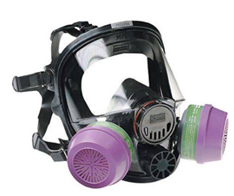

Are these that use n95 cartridges more effective?
Ain't you a teeeny bit overdoin' this ? o_O
It's still not the zombie apocalypse, you know...
