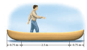

A 55 kg man is standing on a 65 kg and 4.0 m length canoe that floats without friction on water.
The man walks from a 0.75m from one end of the canoe to another point 0.75 from the other end of the canoe.
What distance does the canoe move?

Sorry :frown: Here goes the complete reasoning;
CMo=(1/M)⋅∑xn ⋅ mn= (1/120 kg)⋅[(55⋅0.75 kg⋅m)+(65⋅2 kg⋅m)] = 1.43 m
CMf=(1/M)⋅∑xn ⋅ mn= (1/120 kg)⋅[(55⋅ 3.25 kg⋅m)+(65⋅2 kg⋅m)] = 2.57 m
And calculate ΔCM=CMf-CMo= (2.57-1.43)m = 1.14 m
Would be this the displacement of the boat?

What you have computed is the change in the center of mass in the boat frame. How does this relate to how far the boat moves? What assumptions go into that relation?

No. What is true about the center of mass of both man and boat (assuming that there is no transfer of momentum to the water)?

No, the center of mass does not move. You have computed that the center of mass moves by 1.14 m (1.15 m with correct rounding) it a frame that is attached to the canoe. How far must the canoe move for this to happen at the same time as the CoM does not move in the lake frame?

It may be beneficial to start looking in the lake frame, where the center of mass does not move. What does this tell you about the displacements of the man and boat, respectively?
So, if in the lake's frame the CM of the man and the boat does not move even if they do. This may suggest the displacement of the man is somehow proportional to the boat's?
I mean, if the man walks to the right, then the boar moves to the left?

Correct, but how much?

I suggest you only look at the lake frame. What is the relation between how far the canoe moves and how far the man moves in that frame?
