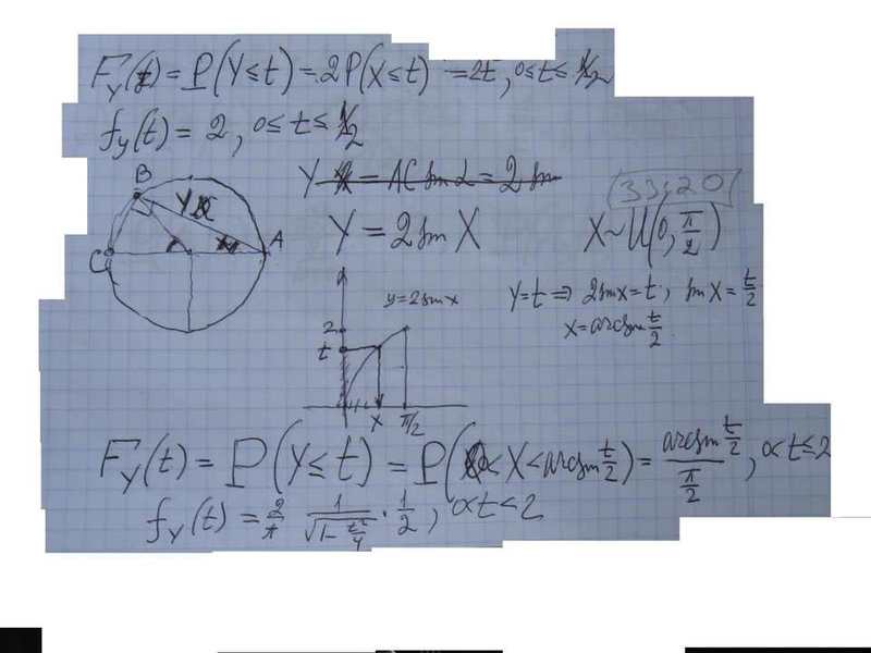

on a circle with radius 1 there are two points one is static the other is
distributed evenly on the circle (i don't know the proper english term)
we sign X to be the hypotenuse on the circle
find the density function of the variable X
solution(i partialy understood it)the questions come after the photo
they say that we take x to be an angle from o til pi/2
we scan only the northern hemisphere because its symmetric.
what is the curv graph represents
what is t?
what is the meaning of y<=t?
why if they say that x should go from o til pi/2?
in the probability function they put x fro 0 till arcsin t/2 where t goes from
0<t<=2
after this step they did the derivative to find the density function
i understand that step

(we usually say "uniformly", but "evenly" is also ok :smile: and we usually say "around a circle")
No, I don't think x is the hypotenuse.
It's a little difficult to tell, but I think x and y are angles …
(and what is t … is it a chord? :confused:)
Let's call the fixed point A, the movable point X, and the centre O. And let B be the other end of the diameter AOB.
Then I think x is the angle between the two points, which equals AOX, and y is the angle ABX.
y is always x/2 (if you don't know that, you need to look at a geometry book).
Carry on from there. :smile:​
