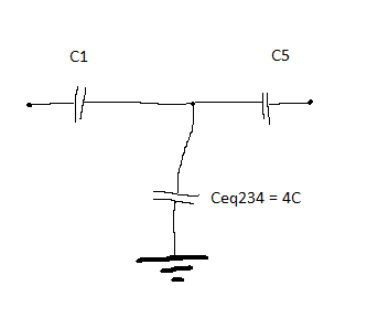

If i open the battery then I would have this?
Yes. But Ceq234 will be 3C and C5 is redundant (i.e. it is not a part of the circuit). So the net capacitance viewed from the battery terminals is C1 in series with C123.

oops, yes it should be 3C. But I'm still having trouble understanding why C5 is not part of the circuit. If I open the battery terminal, the C1 is identical to C5, but yet only C5 is redundant?
If you are opening the battery, you are calculating the capacitance between the top-left node and ground i.e. capacitance viewed from the existing battery terminals. So, one terminal of C5 is connected to the middle node but the other terminal is hanging, not connected to the circuit. It won't form a closed path and hence it won't be charged by the existing battery. Hence, it is redundant.

I have no answer key to the questions, but after asking for clarification, the terminals on the right aren't connected to anything, if that changes anything.
