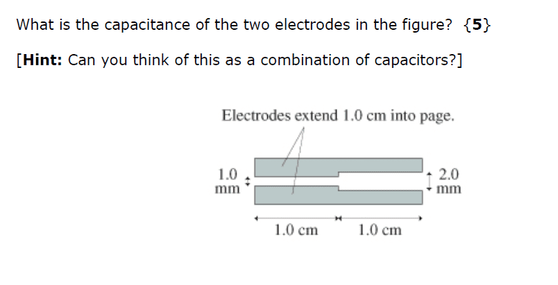

Can I get some help in answering this questions?
As I understand, for two electrodes:
C=εA/d
A = 0.012 m2
d = 0.001 m on the left and d = 0.002 m on the right.
Thus the capacitance of each part is:
Left: C = (εx0.012)/0.001
Right: C= (εx0.012)/0.002
Firstly, is this the right approach? Secondly, what next? Do you simply add the two values to get the overall capacitance?
Help greatly appreciated!
Yes :oldsmile:
Follow the hint. Can you consider these two capacitances as being in parallel or series? If so, which one?
To me, they look to be in parallel. Hence C = C1 + C2. Correct?
Yes. That's right.
Great! Now if you can just turn your attention to my semi-infinite well question ... :wink:
Appreciate the help.
