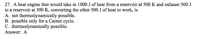

Carnot cycle problem - Is it thermodynamically possible to do 500J of work?

2. The attempt at a solution
Is it only possible when 600J of heat is exhausted and 400J of heat is converted into work? Is the 600J heat will enter the cold reservoir and available to do work again?
q1/T hot + q3 / T cold = 0
q3 = 600 when T = 300K
Good.
where did this come from?
Use your previous equation but make it an inequality, not an equation, reflecting the fact that net entropy can only increase or stay at zero.
You are given q1, q3, Thot and Tcold.
