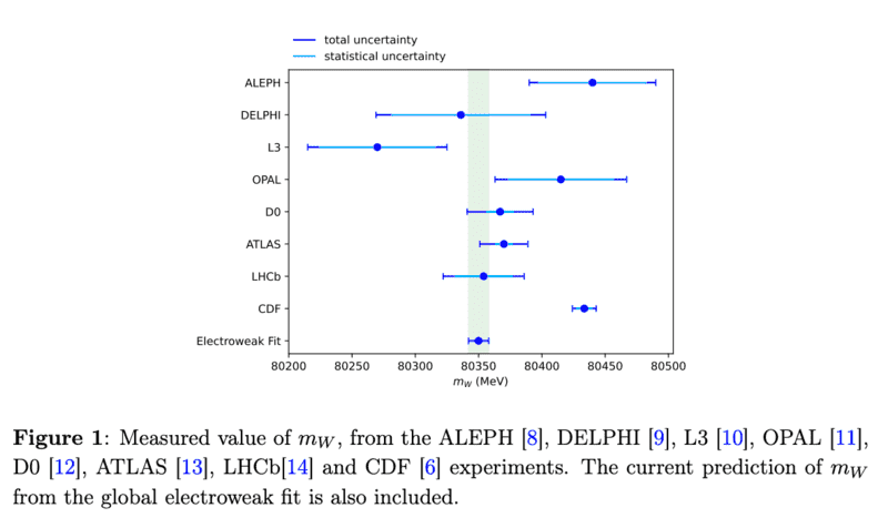

I mean, what we are discussing is essentially this (figure linked from the Science paper):
The main tension if one considers only direct measurements of ##M_W## is between CDF II on the one side and D0 II and ATLAS on the other. Taking the global average for measurements of ##M_W## other than the CDF II one, the disagreement is significant, but not enormous at around ##3.6\sigma##. Unlikely, but not unfathomable by any means.
Then there is the issue of the "SM" in the plot, which @ohwilleke mentioned. This is extracted from other measurements, mainly ##G_F##, the fine-structure constant, and ##M_Z##, but also significantly affected by loop corrections (you would not get a value close to the correct one without those). This is where the 7 sigma anomaly arises, but then it becomes a question of whether or not you trust the errors on that extraction.

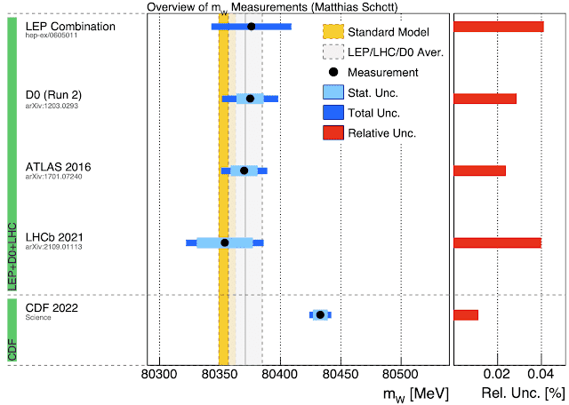

See also with one new LHCb measurement from August 2021, not yet in PDG and not mentioned in the paper:
Chart via this blog which also has quality commentary, which notes that:
The main problem . . . is that the new measurement is in disagreement with all other available measurements. I think this could have been presented better in their paper, mainly because the measurements of the LEP experiments have not been combined, secondly because they don't show the latest result from LHCb. Hence I created a new plot (below), which allows for a more fair judgement of the situation. I also made a back-of-envelope combination of all measurements except of CDF, yielding a value of 80371 ± 14 MeV. It should be pointed out that all these combined measurements rely partly on different methodologies as well as partly on different model uncertainties. The likelihood of the consistency of such a (simple) combination is 0.93. Depending (a bit) on the correlations you assume, this value has a discrepancy of about 4 sigma to the CDF value.
In fact, there are certainly some aspects of the measurement which need to be discussed in more detail (Sorry, now follow some technical aspects, which most likely only people from the field can fully understand): In the context of the LHC Electroweak Working Group, there are ongoing efforts to correctly combine all measurements of the W boson mass; in contrast to what I did above, this is in fact also a complicated business, if you want to do it really statistically sound. My colleague and friend Maarten Boonekamp pointed out in a recent presentation, that the Resbos generator (which was used by CDF) has potentially some problems when describing the spin-correlations in the W boson production in hadron collisions. In fact, there are remarkable changes in the predicted relevant spectra between the Resbos program and the new version of the program Resbos2 (and other generators) as seen in the plot below.
On first sight, the differences might be small, but you should keep in mind, that these distributions are super sensitive to the W boson mass. I also attached a small PR plot from our last paper, which indicates the changes in those distributions when we change the W boson mass by 50 MeV, i.e. more than ten times than the uncertainty which is stated by CDF. I really don't want to say that this effect was not yet considered by CDF - most likely it was already fixed since my colleagues from CDF are very experienced physicists, who know what they do and it was just not detailed in the paper. I just want to make clear that there are many things to be discussed now within the community to investigate the cause of the tension between measurements.
Difference in the transverse mass spectrum between Resbos and Resbos2 (left); impact of different W boson mass values on the shapes of transverse mass.
And this brings me to another point, which I consider crucial: I must admit that I am quite disappointed that it was directly submitted to a journal, before uploading the results on a preprint server. We live in 2022 and I think it is by now good practice to do so, simply because the community could discuss these results beforehand - this allows a scientific scrutiny from many scientists which are directly working on similar topics.
And, again, I also have to think that there are additional LHC results for the W boson mass waiting in the wings, and that those are likely to confirm the ATLAS 2016 and LHCb 2021 results within reason.

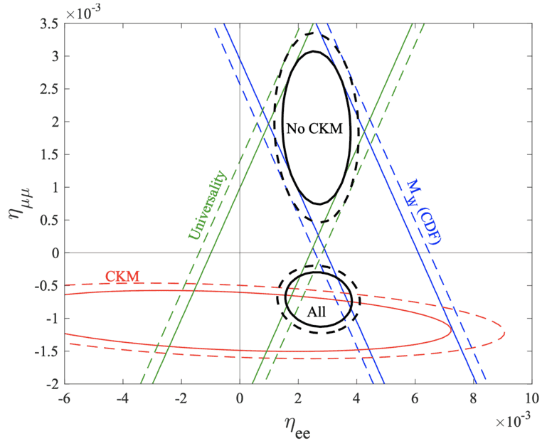

Here's a quick summary of my own (https://arxiv.org/abs/2204.04559):
We considered the impact of right-handed neutrinos on the W mass. Integrating the right-handed neutrinos out leads to a single d=6 operator and the parameters relevant to the W mass are ##\eta_{ee}## and ##\eta_{\mu\mu}## (essentially diagonal elements in the non-unitarity of the resulting PMNS matrix). With right-handed neutrinos only, these parameters must be positive. We fitted these parameters to the CDF measurement, lepton universality constraints, and the CKM unitarity measurements of ##V_{ud}## and ##V_{us}## in beta and kaon decays. This is the result:
Without the CKM measurements, the larger W mass could result from positive values of the ##\eta## parameters. However, including the CKM results both leads to a quite lousy fit that is not really compatible with any of the three data sets. If instead one applies the global average (without the CDF measurement), the situation changes:
The fit is actually pretty good, but since ##\eta_{\mu\mu}## is negative it cannot be the result of right-handed neutrinos only. Instead, other exotic contributions to the d=6 operator would be required to accommodate this fit.
Bagnaschi et al discuss a more general SMEFT approach in their paper https://arxiv.org/abs/2204.05260

Vanadium 50 said:
Inspire says there have been 3000+ publications. Some are conference proceedings, so there is some overlap, but with this many publications, you expect some 1:1000 statistical fluctuations.
I'm only talking about later publications. Inspire has 608 results from 2011 to 2022, 181 of them are labeled as published (5 of them with fewer than 10 authors).
In that list we have the 4.5 sigma B-physics deviation and we have the diboson measurement called "significant" by CDF (I see 3.2 and 3.5 sigma mentioned in the paper). Now we have a W mass measurement that's ~4 sigma away from the average of previous measurements even if we completely ignore theory predictions - CDF calls it 7 sigma away from theory. That's just what I can remember or found with a quick search.
The "ghost events" I linked above (claimed to be significant by CDF but I don't find out how significant) were 2008 so let's skip these.
Many uncertainties are correlated between electron and muon channel, so seeing a deviation in both doesn't mean that much.
Digging through Inspire I found this interesting June 2012 PhD thesis (before we had a good Higgs mass value): An Improved W Boson Mass Measurement Using the Collider Detector at Fermilab
(80.374 ± 0.015 stat. ± 0.016 syst.) GeV using 2.2/fb.
A measurement that's almost exactly matching the D0/ATLAS results.
