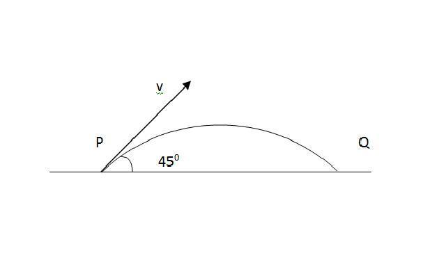

An object of mass m is launched at speed v from point P on horizontal ground at an angle of elevation of 45 degrees, as shown in the picture. When the object reaches point Q the magnitude of the change in momentum of the object is ?
Change in momentum of the object
mv - mu
Honestly, I really don't know how to start
All i know is use the formula of the change of momentum
But then the angle 45 degrees I really don't know where to put..
Can somebody help me
Sorry for not attempting
Is because I am a bit blur..
Lastly the options for this question is
A : Zero
B : 1/2 mv
C : 2mv
D : 4mv
Thanks so much..

Okay i think I might be able to solve it..
Finally I manage to attempt this question..
Initial velocity, v = ( vcos45 )^2 + ( vsin45 )^2 ( using pythagorean theorum ) ( to find the resultant velocity
Therefore initial velocity = v
Hence, initial momentum, p =mv
Final velocity, v is the same in magnitude but opposite direction,
Hence final momentum, p =-mv
Hence, change in momentum,
is -mv -mv
=-2mv
But the question just wants the magnitude,
Hence = 2mv
Can anybody tell me whether my working is correct??
Thanks
Really? Why do you think that?
Also, momentum is a vector:
[tex]\Delta\vec{p}=\vec{p}_f}-\vec{p}_i=m\vec{v}_f}-m\vec{v}_i[/tex]
What force is causing the momentum to change? Which direction does this force act in? Hence, which component(s) of the momentum change?
The final velocity of the object will be pointing downwards..
Hence, the it will be the same magnitude as the initial velocity but pointing downwards..
That is what I think..
Is my answer correct?
Or are there any other answers..
Thanks
