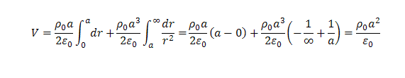

Placing it into first expression i got:
Now my question is, is this correct, i mean is this correct approach for finding potential in examples like this?
Everything looks good!
