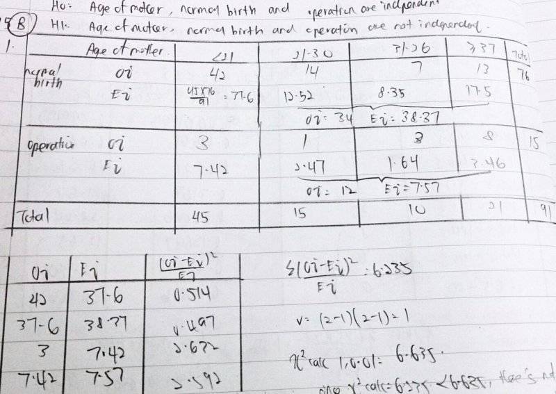

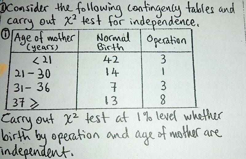

the expected frequency for the age of (21-30, 31-36, more than or equal to 37) for operation is less than 5 , so combination of these numbers are required for the expected frequency to be more than or equal to 5 .
my question is which numbers should i combine?
would my ans be different?
in the solution, i combine the (21-30, 31-36, more than or equal to 37) for normal birth to get my Observed frequency = 34 and expected frequency = 38.37...
for operation, combine the (21-30, 31-36, more than or equal to 37) for normal birth to get my Observed frequency = 12 and expected frequency = 7.57...
can i combine less than( 21 and 21-30 ) , (31-36 , more than 37) ?[/B]

I'm not sure if this was your plan. I would think if you combine the the rows 21-30 and 31-36, or 31-36 and 37+, then that'd fix the problem.
For your second question, why don't you just compute both and see if one contradicts the decision of the other?
