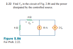

Applying KCL at the node , assuming current flows from left to right at the 4 ohm resistor:
Vo/4 + 10 + 2Vo = 0
OR, is it :
Vo/(4+6) + 10 + 2Vo = 0
since the two resistors are in series?
goonking said:
[/B]
Vo/4 + 10 + 2Vo = 0
OR, is it :
There are two parts to this problem.
1. find vo
2. find power dissipated by the controlled current source.
remember V=IR
you know what R is (4). you need to solve for the current, so you write a KCL.
so...
Vo/4 + 10 + 2Vo = 0 is correct.
think about it... that 6 ohm resistor does not effect Vo at all. because Vo is related to the current through the device and the resistance of the device. the sources are CURRENT sources. so the current will be the same independent of the 6 ohm part.Now to find the power you'll need to write another equation. there are a few different ways you can do it.

so would it be different if the one of the current sources was replaced with a voltage source?
Yes. It would be, because with a voltage source there is constant voltage, so the greater the voltage drop across one resistor, then less drop across the other. with a voltage source it is the relationship between the two resistor that determines the voltage drops.
an ideal voltage source will create any current necessary to make the desired voltage.
an ideal current source will create any voltage necessary to make the desired current.

Im very confused by this statement. there is no voltage source, only current sources.
the current through that 6 ohm resistor will ALWAYS be (10 + 2Vo) amps.
The current sources will produce whatever voltage is necessary to create the desired current.
My mistake, I didn't recognize the Voltage meter symbol.
But now I don't understand the V0 sign indication at the 4 Ohm resistor
I believe it's the voltage drop across 4Ω resistor.
Vo=4*(10+2Vo)..
that diamond is not a voltage meter. it is a dependent current source.
cnh is right when he says that the Vo sign is simply indicating what the voltage drop is. You can think of that as a meter if you are a hands on person.

Can someone explain the sign language here ? Why is 2V0 a dependent current source ? And 100 A, where does that come from ? And the sign of V0 over the 4 ##\Omega## ?
A common symbol for a controlled source is the triangle. Controlled sources may be current sources or voltage sources and as the name suggests their output is controlled by some external quantity. Usually this external quantity is a potential difference or current located elsewhere in the circuit. It is presumed (and usually not shown in the schematic) that some circuitry or mechanism exists to monitor and measure the external control signal and feed this information back to the controlled source where it is acted on to control the source's output.
In the present problem there is some hidden mechanism that determines the potential Vo across the 4 Ω resistor which is then used to meter the output of the controlled current source according to the specification I = 2 Vo. Note that it is always implied that the constant multiplying the measured value has units associated with it that make the result come out with the desired units. In this case the "2" should be read as 2 amps per volt.
The Vo label on the 4 Ω resistor is there to inform you how the potential difference across that resistor is to be interpreted in terms of its polarity. Think of it as how you would connect the leads of your voltmeter in order to measure it. Reverse the leads and you would change the sign of measurement value. If you were to change the polarity of the Vo label then the circuit would behave differently: The direction of the current produced by the controlled source would be reversed.
As far as I can tell the 100 A is part of a hypothetical example introduced by goonking in post #7. It's not part of the original problem.

another question, but aren't the polarities on the Vo resistor suppose to be switched/flipped ( maybe a typo?) since current can only flow from right to left in this case.
goonking said:
another question, but are the polarities on the Vo resistor suppose to be switched/flipped ( maybe a typo?) since current can only flow from right to left in this case.
The polarity of the Vo label has nothing to do with the current. It simply tells you how to read whatever potential difference is there: where to (conceptually) connect your positive and negative meter leads. The actual potential difference that the current produces across that resistor may well have the opposite polarity, in which case Vo will be read as a negative value.
I was told resistors don't have polarity, but in the diagrams, they do. Are the polarities on resistors only used when applying Kirchoff's Voltage Law?
goonking said:
I was told resistors don't have polarity, but the diagrams, they do. Are the polarities on resistors only used when applying Kirchoff's Voltage Law?
Resistors have no inherent polarity. Any polarity attributed to them is either an artifact of an assumed current causing a potential drop (KVL) or because the circuit designer is telling you how to interpret a voltage reading across that resistor.
If a circuit diagram has multiple loops and the resistor polarities aren't indicated, is it still possible to apply Kirchoff Laws? Or do we have to assume flow of current and then polarity of resistors according to our assumption?
goonking said:
If a circuit diagram has multiple loops and the resistor polarities aren't indicated, is it still possible to apply Kirchoff Laws? Or do we have to assume flow of current and then polarity of resistors are then labeled accordingly?
It's up to you to choose assumed currents for your analyses and label the resulting voltage drops. It's very rare indeed that you'll find a circuit diagram with potential drops pre-labeled for you. Kirchhoff's laws always hold; they are a matter of the physics and independent of any labeling. But you will frequently find particular currents and voltages associated with controlled sources to be indicated.
