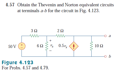

Circuit schematic with a 50 V source, 3 ohm and 2 ohm resistors, a 6 ohm resistor, a dependent voltage source 0.5v_x controlled by vx, a 10 ohm resistor, and terminals a and b.
Attached to this post. I had to take the absolute value of Rth. What did I do wrong to get a negative value for Rth?
No doubt it has to do with the direction of the current that you're "injecting" into the circuit versus the polarity of the resulting voltage across the terminals. The resistance of a component (or circuit for that matter) is defined as the current into the port divided by the resulting potential across that port. The polarity of the voltage "measurement" is such that the terminal where the current is injected is taken to be positive:
Circuit diagram of a rectangular box labeled Component or circuit, with current I_in entering the top terminal from the left and voltage V_in marked across the two terminals with the arrow pointing up and the bottom terminal arrow pointing left.
  • Two-terminal black box labelled Component or circuit, with current I_in entering the top terminal and voltage V_in marked across the terminals with the top terminal positive.
So my mistake was that the 1A current source was pointing down when it should've been pointing up?
Not a mistake per se, not if you take it into account when you assign the polarity of the voltage. You are looking for the potential at terminal a with respect to terminal b, so automatically that implies that the a terminal is the where you'd put the + lead of your meter (if you were measuring it). You are driving the current into the b terminal, so it becomes the "+" terminal for the resistance determination. That's contrary to the desired arrangement, and will result in a reversed sign for the voltage Vab.
