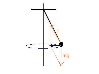

You swing a marble with mass m attached to the end of a string in a horizontal circle as shown in the figure below. The angle that the string makes with the vertical is
θ = 37°.
(a) Find the speed of the marble when the string is 26.0 cm long.
soh,cah,toa
Ar = v^2/r
4ii^2r/T
I solved for the radius by using trig, but now I don't know what to do. Without mass or revloutions, I don't know how to solve form the speed.
Draw the free body diagram: What forces act on the marble? What is the resultant when the marble moves along a horizontal circle? You do not need the value of the mass: it will cancel.
ehild
You have gravity and force of tension
Yes, and what is their resultant?

if its moving in circle, then some force should be providing centripetal force. Here that force is horizontal component of tension. And since the ball isn't moving up or down, force of gravity should be balanced by some other force, namely vertical component of tension.
just as ehild said, making free body diagram would make it more clear.

The resultant of the tension and gravity is equal to the (horizontal) centripetal force. How is it related to mg and the angle of the string with the vertical ?
