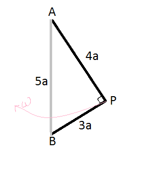

2)
the ends of a light string are fixed to 2 points A B in the same vertical line with A above B,and the string passes through a small smooth ring of mass . the ring is fastened to the string at a point P and when the string is taut the angle APB is a right angle,the angle BAP is T and AB=5a AP=4a. the ring revolves in a horizontal circle with constant angular velocity w and with the string taut.
if the ring is free to move on the string,instead of being fastened, show that it will remain in the same position on the string if the angular velocity,w,satisifies

You meed to make sure that the ring at P does not move up of down ... What should be the condition for that?
Hint: It has something to do with Tension in the string ...
this is what i am unclear on. how does the tension work if the ring is no longer attached to the bead? suely all the forces acting on the bead now are reaction force and mg down?

The two tensions in string will act so that they can provide the necessary centripetal force ... It won't be wrong to assume the string to be ≈ 0 ...
so you can say that the tension in upper and lower (of length 4a and 3a) to be ______.
now all you need to do is that equate sum of their horizontal components to ______ and sum of vertical to ______.

if i look at the ring,as its not attached to the strings surely i only have mg and reaction force acting on it?
where does the reatcion force act? in your diagram you have it pointing in towards the centre,why is that? i would put it perp to the contact, but is it in contact with the top string or bottom string?
my equation of motion would then be
horizontal component of R=mv^2/ (radius of circle)
where does the tension come into play?

What, according to you, is the origin of this reaction force?

Well there will be a reaction from the string ... and that reaction will be in the form of tension
Imagine it this way ...
The ring when rotates about a center will e pushed out in tangential direction if there is no centripetal force ... Thus let's assume that initially ring does move out tangentially ...
it will strike the string and will push it out ... not the string will get deformed as we saw in this case (making angle 90° with itself) ... now the different parts of string will stretch out and there will be a force (electrostatic) which will try to out string back in original shape ... And of course this force shall be tangential to that string's surface. We call this force TENSION in the string
And because the string is light, this tension will be of same magnitude at all parts of the string ...

are you saying,if i resolve vertically and horizontally i have
i have
x-component of T=v^2/r
y-component of T=mg

I'm not sure you are quite understanding how the tension works here, since there are actually two forces, each of magnitude T, but acting in different directions.
Here is how we can convince ourselves of what the forces are:
Imagine a short section of the rope, the short curved or bent section that is in contact with the mass. Using cupid.callen's earlier figure, this would be a small section of rope located at point P:
The forces acting on this small rope section are:
1. Rope tension T from the upper straight section of rope.
2. Rope tension T from the lower straight section of rope.
3. The contact or reaction force of the mass acting on the short section of rope.
Since this rope section is considered massless, the net force acting on it is zero (F=ma and m=0). Therefore, the reaction force due to the mass is equal in magnitude, but opposite in direction, to the vector sum of the two tension forces.
Now consider the force exerted by the rope on the mass. By Newton's third law, it is equal in magnitude, but opposite in direction, to the force exerted by the mass on the rope. Therefore, it is equal to the vector sum of the two tension forces exerted by the two straight sections of rope -- i.e., same magnitude and direction as this vector sum.
Hope that helps clarify things.

thanks.
no examples like this in my book,so i have not seen this idea. would never had got this!
well i thought i got it,but when i came to do the question still drew a blank.
when you say vector sum of the 2 tension forces do you mean
resolve the 2 tensions into x component i+y component j
then add to get
sum of x components of 2 tensions i+sum of y components of 2 tensions j
and then when i resolve horizontally i just take
sum of x components of 2 tensions=mv^2/r?
sum of y components =mg?
I assume T is not the same as T from the first part of the question?
then add to get
Yes, that's right.
As long as you account for the fact that one of those y-components is in the downward direction, therefore negative, then yes.
I don't understand. Question 2 only has one part. If you mean that T is not the same as in Question 1, then yes -- they are separate independent questions and you should not think that something in one of the questions has any relevance to the other question.
my mistake,i have only put the second part of the question as i done the first.
it was to find the tension in each string when ring is attached, which gave values 10mg and 6mg. my question means is T in the second part the same as these values or is T the same in each part of the string so i need to eliminate it using vertical component f=ma?
T is the same for both sections of string in this case -- and not (necessarily) equal to either tension value from the first part of the question.
