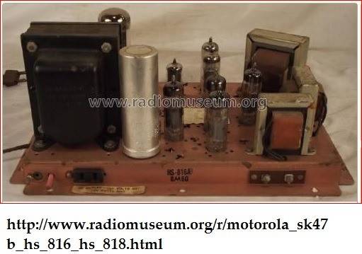

Motorola used the bi-amp approach in late fifties/early sixties. Bass isn't very directional . My family's hi-fi was a Motorola SK47 console..
http://www.radiomuseum.org/r/motorola_sk47m_hs_816_hs_818.html?language_id=2
It used two sets of push-pull 6BM8's( i think)maybe ten watts a side, driving 8" mid and 5" tweeters left and right, and a push-pull 6BQ5 stage maybe thirty watts to a 15 inch woofer in the center. Sound was fantastic for the time.
All powers were listed as peak instantaneous, probably 4X the true power.
I duplicated the amplifier and took it with me to college in '64, just mounted speakers in a wood box. It was regarded best sounding system on the floor.
