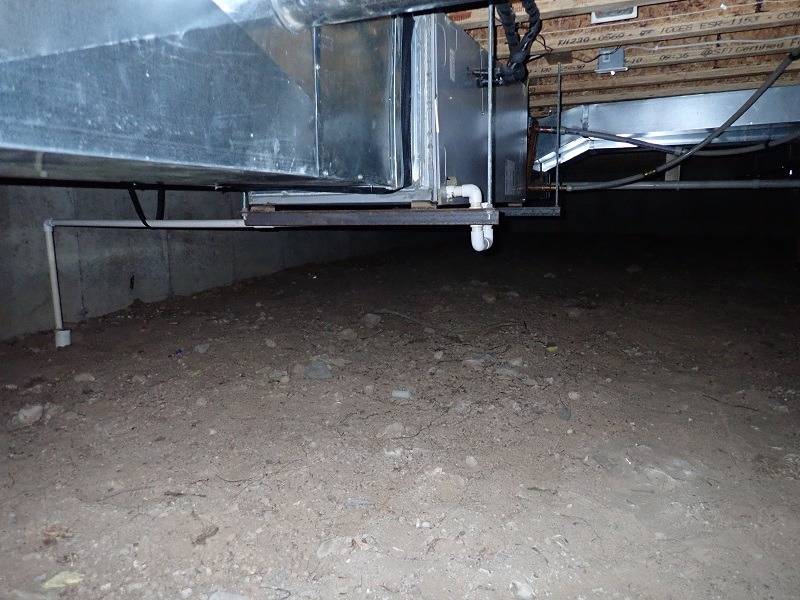

The bottom of my crawlspace is a few inches above the peak water table. The drain tile around the house has water running several months out of the year. There is a 6 mil polyethylene vapor barrier underneath the foam insulation. The foam is covered by 2" - 3" of sand for fire protection:
The white pipe on the left is the drain line for condensate from the air conditioner, boiler, and heat recovery ventilator. It drains into the drain tile instead of into the sanitary sewer because trickle flows are a primary cause of frozen sewer lines. We have a conventional septic system.
What's that big silver/metal thing? It looks like a refrigerator!
