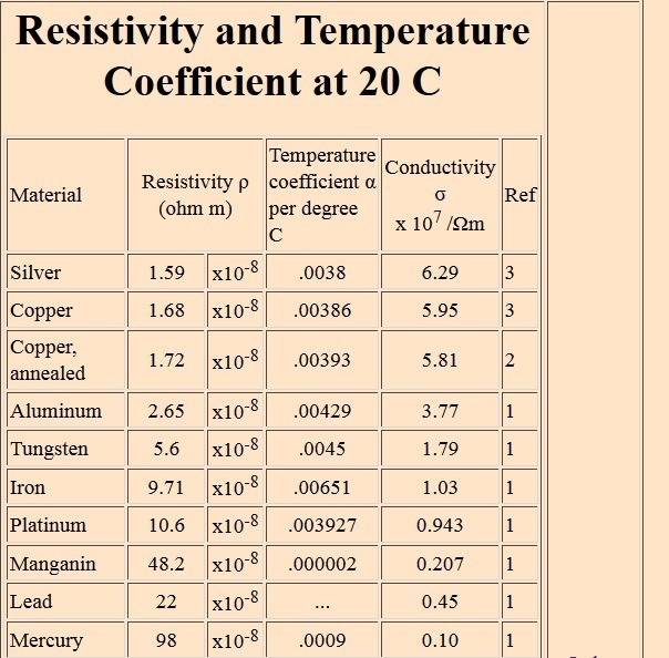

Here's some a's from hyperphysics
http://hyperphysics.phy-astr.gsu.edu/hbase/tables/rstiv.html
looks like you might have a 1000 ohm iron-ish wire sensor ?you might read up on the "Callendar Van Dusen" equation.
