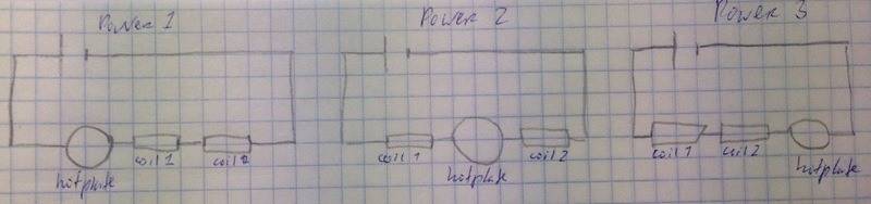

(b) Not even sure where to start. Am I required to make a circuit? What are coils in a circuit? Resistors? What is a hotplate in a circuit? A cell?

Maybe it should be something like this:
There is no circuit element "hotplate". A hotplate is just a metal disk with heating coils below (or inside). The interesting part as far as this problem is concerned is the two resistive coils. So your circuit diagrams should contain only power supply and resistors.
You need to determine how to apply voltage to the resistors to get three different power settings.
I can only think of: (i) power supply in series with two resistors in series and (ii) power supply in series with two resistors that are in parallel.
Nowhere does it say that both coils have to be in use at the same time :wink:

Maybe then:
and (iii) power supply in series with just a one resistor.
gneill said:
Yes.
And this means
moenste said:
In each case, calculate the power rating.
that we need to calculate the power (like P = V I or P = V2 / R) for each of the graphs?
gneill said:
Yes.
Then we would have:
  1. One resistor: P = 2502 / 78 = 801 W.
  2. Two resistors in series: P = 2502 / (78 + 78) = 401 W.
  3. Two parallel resistors: P = 2502 / 39 = 1603 W. (1 / R = 1 / 78 + 1 / 78 → R = 39 Ω.)
Looks good.
