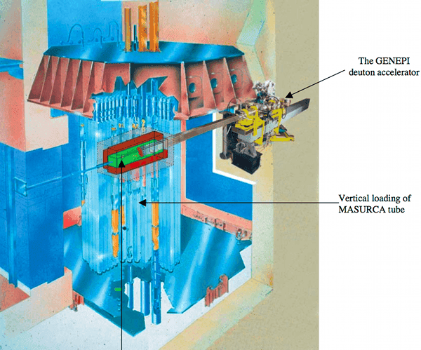

So will this work? Is a combination of PWR and these things likely to get a fuel cycle as efficient as the fast breeders? Can it burn the sterile plutonium? Could it burn thorium?
D+T fusion produces fast neutrons (14.1 MeV), so there has been thought about using U-238 blankets to produce Pu-239, as well has heat. The blankets could be cooled by Li, and the heat transferred to a conventional steam Rankine cycle.
ppnl - I don't think this particular design is intended to produce power - it's just waste disposal, transmuting minor actinides and some fission products with fast neutrons from D-T fusion.
But the concept of fusion-fission hybrid power reactors is sound. A closely related idea is an accelerator-driven subcritical reactor, which uses a spallation neutron source (proton accelerator aimed at a heavy metal target to produce neutrons) providing fast neturons to "drive" a fission reactor that is otherwise in a subcritical state. (This also goes by the name "energy amplifier", because the fission reactor produces more than enough energy to power the accelerator that drives it). The point is, the neutron spectrum is very hard (because of the spallation neutrons), so you get efficient transmutation like in a fast reactor, or better.

I suppose a fusion-fission hybrid would be similar to an ADS, with fusion providing fast neutrons to drive a subcritical mass of fissile isotopes. I don't know about the relative advantages of the three different methods (ADS, FR, fusion-fission), but fusion has hotter neutron spectra than all fast fission reactors, so it's probably more efficient at transmuting the minor actinides.
But if you burn up all the left over uranium and plutonium how can you avoid producing energy? It seems no different than a fast breeder in fuel requirements and even seems to allow a wider range of possible fuels. But breeder reactors have a history of problems and may take a very long time to bring to market. I have no doubt that they can work and if nothing better is found the should be built. But would the fusion/fission system be less complex and easier to bring to market? And can it burn thorium directly?
The problem with accelerator driven reactors is that they use a great deal of energy to produce the fast neutrons. I'm basically viewing the fusion/fission reactor as a more efficient way to produce those neutrons.
