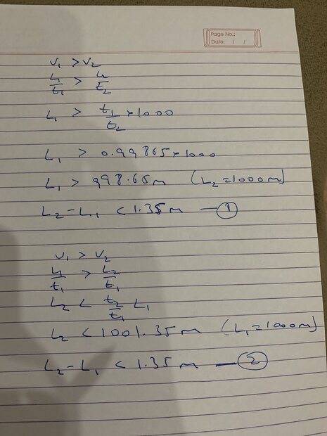

In 1 km races, runner 1 on track 1 (with time 2 min, 27.95 s) appears to be faster than runner 2 on track 2 (2 min, 28.15 s). However, length L2 of track 2 might be slightly greater than length
L1 of track 1. How large can L2 - L1 be for us still to conclude that runner 1 is faster?
Vavg = total displacement/ total time
First I calculated the avg velocity with 1000m for both runners. It came 6.76m/s and 6.75m/s. It suggests that the velocities are same. This means yes that the L2 track is slightly longer than L1.
Then why is it asking this question (…that runner 1 is faster)? Both are at equal speeds.
I don’t get the question really.
If we really want the runner1 to be faster we need to shorten his track.

Often, I find the hardest part of the problem is picking a good set of variables so that one can write down some good equations that are easy to solve.
You pick up some tricks over the years. One trick is that when you see an inequality ("less than", "greater than", "at least", "at most", etc), you want to look for the boundary. The boundary is an equality. You can write down an equation for it. Equations are good. You can solve them.
So when the problem talks about one runner's velocity being greater than the others, you know almost immediately that you are going to be writing down an equation that is basically:$$v_1=v_2$$So take out a piece of paper and at the top of it write down that equation.
Now, ##v_1## is ##\frac{L_1}{t_1}## and ##v_2## is ##\frac{L_2}{t_2}##. Update your equation accordingly.
The problem hints that you can take ##L_1## to be fixed at 1 km exactly and vary ##L_2## so that the equality is satisfied. That leaves you with one equation and one unknown.

You do not know that. Your calculation to that effect in post #1 was flawed in two ways:
1. You assumed they both ran 1km exactly, even though you are told that may not be true.
2. You did not keep enough precision for the small difference in their times to result in a difference in speed.
However, the question asks you to find the length difference that would completely account for the time difference, i.e. on the assumption that they did run at the same speed.

@jbriggs444 I have done the solution. And it turns out L1-L2 < 1.35 m.

I agree with your answer. A simpler method is this:
- find Runner-1's speed (assuming L1 = 1000m);
- find the extra time Runner-2 runs;
- assuming the runners have equal speeds, ask yourself how much extra distance Runner-2 covers in the extra time.

Strictly speaking, we don’t know which track is exactly 1km, if either. So all we can calculate is the ratio of lengths that would account for the ratio of times,
