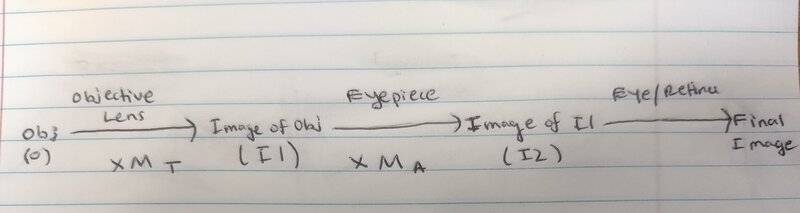

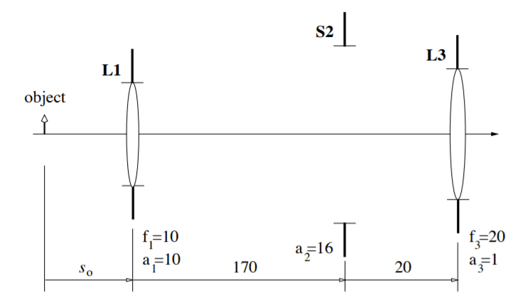

Ok so for a compound microscope system like the one below, Magnification power is ## MP = M_T * M_A ##. My present understanding is that ##M_T## refers to the magnification by height ratios of the object through L1, and ##M_A##, in this case, refers to the ratio of unaided and aided angles of "the image of the image formed by L1" formed on the retina.
Taken from MIT OCW 2.71: https://ocw.mit.edu/courses/mechani...s-spring-2009/assignments/MIT2_71S09_ups3.pdf
Now I was kind of confused about how we could sort of cascade the ##M_T## from L1 with the ##M_A## from L3 to obtain ##MP##, but I think I made sense of it by thinking about it like a system in the diagram below, and realizing that ##M_T##, ##M_A## and ##MP## are all dimensionless. But I'm still not sure if my interpretation is right. I'm thinking that the Final image on the retina is an image of I2, which was just I1 angularly magnified by ##M_A##. And then ##M_A## was just O laterally magnified by ##M_T##. So then to obtain the total magnification of the object we would say I2 is I1 angularly magnified by ##M_A## and I1 was laterally magnified by ##M_T##, so we just sort of intuitively multiply these together?
My main confusion is about this ##M_A## term and what it really is. One thing I read was that ##M_A = \frac {1} {M_T} ##. If that's the case, does that mean a really high angular magnification from L3 on the retina is a really small lateral magnification of the object on the retina? Ie if an object has a high angular magnification on our retina (not sure if that means breadth or something) will it appear to be really small in height on our retina? And just because it appears small on the retina, does our brain actually register it as small? Or is it just appearing small because the way our retina is curved?

Oh okay. So basically (if I'm getting this) in the moon example, the lateral height of the moon image we see is probably a lot smaller than the lateral height of the moon itself. But to call that a "small image" would be overlooking the fact that the "moon" is now so much closer to our eye as a virtual image? So now what's more relevant is the angle we subtend to the image vs the angle we subtend to the object (which I suppose is angular magnification), ie how much of our field of view that the image captures vs the how much of our field of view the object captures.
So now for the definition of magnifying power of a compound microscope, I suppose the reason we use ##MP = M_{T}^{objective} * M_A^{eyepiece}## instead of ##M_{T}^{objective} * M_T^{eyepiece}## or ##M_{A}^{objective} * M_A^{eyepiece}## because ##M_T## is more relevant for the objective and ##M_A## is more relevant for the eyepiece?
