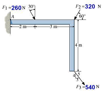

See diagram for problem
additional instructions
For each of the three forces shown, compute the moment (N m, + CCW) about point A. Assume 3 SF for all numbers.
I am trying to solve for the moment(torque) of F3
Force * (Distance between force and point A) * sine(theta)??
That's it! Problem over right there. Tounet = F.r.sinX. Add the torques seperately, one by one.
For force 3, the r value is supposed to be the direct line between it and the point of pivot right? Do I use the hypotenuse of the triangle for the r value? Also what angle do I use (arctan (3 / 4)??), and am I supposed to somehow break up the force into x and y components? I've tried some of this stuff, but none of it seemed to work. Thanks for your time.
Right.
Sure.
When using r F \sin\theta, the angle is the angle between the position vector and the force vector.
You can always break a force into its components and then find the torque for each component and add them. (That would be much quicker, especially if you realize that r \sin\theta is the perpendicular distance to the line of the force.)
