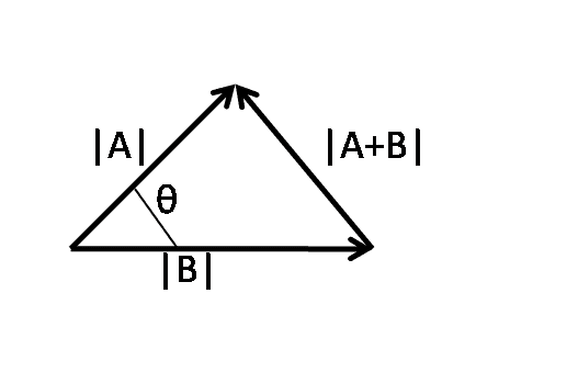

If two vectors, ##\vec{A}## and ##\vec{B}## make an angle ##\theta## with each other, what is the magnitude of resultant of the two vectors?
I don't quite follow. I have never seen the sum of two vectors in terms of their angle.
I don't know how it is at your place but that's something taught at the very beginning here.
Okay, if you haven't seen it, you can use cosine rule to derive it. Draw a vector diagram.
No, I would much rather see your method, please.
Apply cosine rule to the triangle shown in the attachment.

When you say cosine rule, do you also mean the law of cosines? The law of cosines for vectors is simply the dot product, is it not?
Yes, very sorry, it is the law of cosines. I am used to calling it the "cosine rule". :redface:
To avoid confusion, I am talking about this: http://mathworld.wolfram.com/LawofCosines.html
So, you are suggesting that by solving the law of cosines for theta, it will equal 90 deg.?
You can see it yourself. Apply the law of cosines. Show your work.
Sorry it took awhile to reply. Well, after applying the Law of Cosines, the problem became rather trivial: it's all a matter of memorizing those tricks and formulas of mathematics. At any rate, Pranav-Arora, I thank you very much for time.
