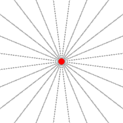

In the image below (from http://www.tapir.caltech.edu/~teviet/Waves/empulse.html) we have a charge subject to an impulse of a finite time duration. The result is a component of the electric field that is transverse.
If we have charges in a current jumping from one conductor to another conductor in relative motion (such as in a slip ring), then we should expect that these charges will be accelerating. But in our case this acceleration occurs in a "pillbox" that is moving inertially (if moving at all). So if we imagine a steady flow of electrons between these conductors, we should expect a curl of the electric field be produced due to the individual acceleration of each electron. We would in effect have an electric field that could induce current in a separate wire loop. But if that is true, then the only time we might expect the transverse distortion of the electric field to reverse is if we were to reverse the current. So this induction in question would not be alternating, as if being produced by an ever-increasing magnetic field (which clearly ISN'T happening here). A steady direct current could easily be supplied by a battery, and such current crossing the gaps between two relatively moving conductors would consist of accelerating charges, and so CLEARLY we have a problem.
The Maxwell-Faraday equation (one of Maxwell's equations - see above) says that the curl of an electric field occurs simultaneously with a changing magnetic field, but here the current densities are constant and so our magnetic fields should also be constant (despite acceleration of charge across the gaps between the two relatively moving conductors). If the curl of the electric field is non-vanishing in these conditions due to the convective acceleration of charges, then it would violate the Maxwell-Faraday equation. But then, if we were to enforce the Maxwell-Faraday equation, then that is to say that despite the acceleration of charges, the induced electric field would be curl free. Why wouldn't the accelerating charges in the gaps induce an emf in a external conductive loop? Or would they actually do so without changing magnetic fields (which would violate the Maxwell-Faraday equation)?

I am trying to understand what results from this. If we are talking about the transverse electric field, then the first term cannot explain that as it is simply the negative gradient of a scalar field. Only the second term would originate the transverse electric field. However, if we have constant current densities, it is hard to imagine how this could possibly maintain the same rate of change. Something does not seem right about this to me.

I am not sure what you mean by "transverse" in this context, but in the Lorenz gauge you can just apply Jefimenko's equations to see that A is constant so that term is 0. The E field would be entirely due to the charge density and would indeed be the negative gradient of a scalar field.
If you are thinking of some different field then you are making a mistake.

So even though the electrons would be accelerating, in this case since the charge and current densities are constant, what you are basically saying here is that the E-field is still non-rotational.

In your described setup there is none.
Yes. That follows directly from the retarded potentials.
