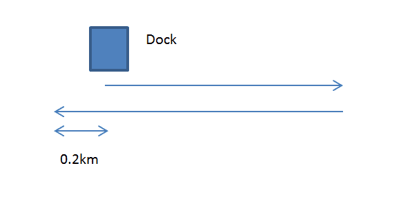

A vacationer gets into his out-board motorboat and leaves a dock on a river bank for a day of fishing. Just as he turns upstream, he hears a splash but pays no attention and continues cruising at normal speed. 30.0 minutes later he realizes that his watertight lunchbox is missing. He then turns downstream, with the motor still set at cruising speed. He sights his lunchbox floating down the river and retrieves it at a point 0.2 km downstream of the dock. How long after turning around does he pick up his lunch?
v = s/t
I can't figure out anything in the problem. I don't know how to set it up.

Draw the vectors for the velocity? The only one remaining then would be the one that is down the stream by 0.2km. How can i proceed from that?
Thank you very much
When I said "draw the vectors" what I meant was DRAW THE VECTORS! Show us your work so we can see exactly where you are stuck.

Isn't this velocity measured with respect to where the boat departs from (say the dock?)

I've got the vectors in here
  • Diagram of a blue square labelled Dock, with a rightward arrow below it, a longer leftward arrow beneath that, and a short double-headed arrow labelled 0.2km.
Nope. The setting of the throttle on the motor has no connection to the dock. The boat has no idea if its running up-stream, down-stream, or any direction related to the shore. The only thing the boat is mechanically "connected" to is the water itself...
Okay. How can I proceed from knowing that fact?
Well, that's the sneaky bit that gives away the solution to these types of problems :biggrin:
If the boat's speed is always relative to the water it travels through, then for events that occur only on the water you can take the water itself as the frame of reference (where you base your coordinate system).
Forget the dock, forget the banks, forget the land entirely. For all intents and purposes you are moving on a motionless surface that is the body of water (in your mind, transform the river to a motionless lake). Now reinterpret the problem from the moment that the lunch box is dropped.

Thank you so much gneill! I finally got the answer which is 30.0min.
