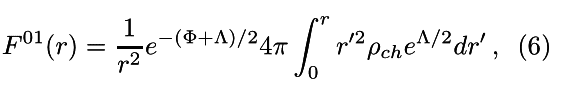

I mean equation 6, the electromagnetic tensor defined there has only two components, F_01 and F_10:
Equation (6): F^01(r) = (1/r^2) e^(-(Φ+Λ)/2) 4π ∫ from 0 to r of r'^2 ρ_ch e^(Λ/2) dr', with Φ and Λ in the exponents.
You can see that it has the metric potentials inside: [itex]\Phi[/itex] and [itex]\Lambda[/itex]
Equation (6): F^01(r) = (1/r^2) e^(-(Φ+Λ)/2) 4π ∫ from 0 to r of r'^2 ρ_ch e^(Λ/2) dr', with the integral sign and limits 0 and r shown.

No, the electromagnetic tensor F -> F_01 and F_10 components.

OK, I saw the way the metric is written. I think the metric coefficients are there to raise or lower indexes, but I have not fully understood where it all comes from. I have run out of time, I'm sorry if my replies have not helped.

Mentz114 is correct, the connection coefficient terms cancel because ##F_{\mu \nu}## is antisymmetric and the connection coefficients are symmetric, so covariant derivatives can be replaced by partial derivatives. So ##F_{\mu \nu}##, with two lower indexes, does not contain any metric coefficients.
However, in order to get the stress-energy tensor from ##F_{\mu \nu}##, you have to raise some of the indexes, and that brings in the metric coefficients. For a pure magnetic field in the ##z## direction, we will have ##F_{12} = - F_{21} = B## as the only nonzero components of the EM field tensor (note that this is in Cartesian coordinates, not cylindrical; I haven't worked out the cylindrical case, but it should be straightforward to transform into it from Cartesian). (Note that this is different from the EMT in the paper you linked to because that paper is analyzing a different scenario, a spherically symmetric charged object.) So the SET will be, using Mentz114's formula but with the general curved metric ##g_{\mu \nu}##:
