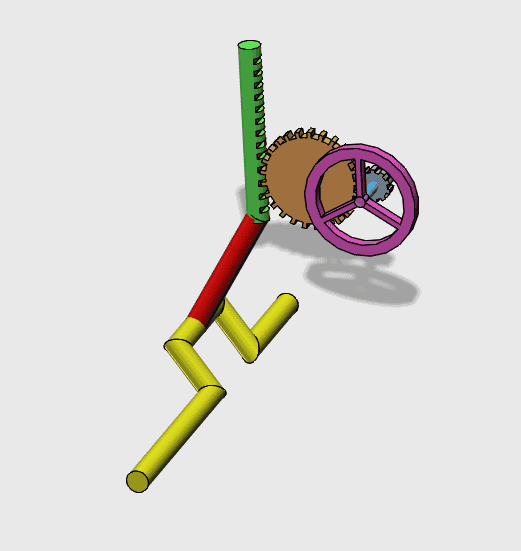

I am working on a mechanism which controls the release of energy while remaining energy efficient. An image of the concept is shown below. (The image is meant simply to get an idea of how it would work- it is by no means perfect).
A source of energy (from a spring being released, for example) applies a torque on the yellow crankshaft. This drives the green rack up and down via the red connecting rod. This in turn drives the brown gear. The brown gear rotates the blue gear increasing its velocity, and this blue gear is connected to the purple flywheel. This flywheel is forced to oscillate rapidly. However, due to the momentum of the flywheel, it forces the mechanism to operate at a slower speed. This slows the rate at which the energy is released.
To smooth out how energy is released, a freewheel can be connected to the yellow crankshaft. Another flywheel would be connected to the freewheel. This flywheel should have a smooth motion.
I would appreciate any thoughts on whether or not a mechanism such as this would work.

You ask if it will work ...I'm not sure what it is you are trying to do ... you say ... 'it's a mechanism which controls the release of energy' , from a spring ...I'm not sure it would do that , give an example of where it would be used ... have a look at a wind up watch , that has a mechanism for the controlled release of a spring

Yes ... that makes things clearer ... But ...
So we have the green rack going up and down , but this will just make the brown gear go back and forth , not rotate .

It was my intention for the brown gear to rotate back and forth That back and forth rotation will cause the flywheel to rotate back and forth as well. I admit that I should have been more specific by what I meant when I wrote that it rotates.

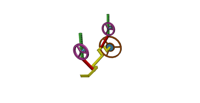

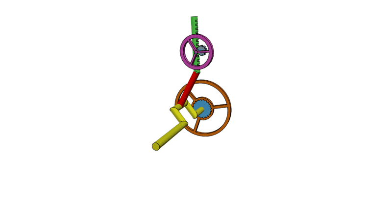

This is an image of the mechanism with the freewheel and flywheel contraption which I wrote about before included. In this image the yellow crankshaft is the input while the brown flywheel is the output. The crankshaft rotates the blue freewheel. The freewheel rotates the brown flywheel. The output should have a smoother motion than the input.
3D CAD render of a mechanism: yellow bent crankshaft driving a blue freewheel gear on an orange flywheel, linked by a red rod to a green rack and a purple ring gear at top.
One issue that may occur is that, even the flywheel oscillates at a high rate, the oscillating accelerations of the flywheel it may be difficult to deliver a smooth continuous motion to the bicycle driving wheel resulting in an effect similar to riding a single cylinder motorcycle at low rpm in which the sensation is a bit like riding a very short legged rabbit.
That is one of my greatest concerns at the moment. However, I'm unsure of which flywheel you're referring too. I am aware that the purple flywheel intended to keep cadence will oscillate quickly. However, I'm hoping that the brown flywheel, intended to smooth out the motion, will not oscillate as you described.
One method which I think may further smooth out the motion is to include two of these mechanisms on the crankshaft out of phase of one another, similar to multiple pistons on an engine. This is a rough outline:
CAD render of a linkage mechanism with two purple-rimmed flywheels on green shafts, a large brown flywheel with spokes, red and yellow links, and a blue hub on a yellow crank arm.
I am however hoping that with the blue freewheel and brown flywheel smoothing out the motion, this would be unnecessary.

I've got a few comments. I'm assuming that the spring on the crankshaft stores energy by being wound several revolutions like a clock spring, not just a fraction of a revolution.
1) The crank/slider/rack/pinion will not affect the mean energy release rate of the wound spring. When the rack-mounted flywheel speeds up, it absorbs energy from the main flywheel, but when it slows sown, it returns the energy (minus friction). So if the main flywheel is rotating at, say, 300 RPM average, the crank/slider mechanism would just add an oscillation, so speed would vary from maybe 280 RPM to 320 RPM, repeatedly. And it will make the whole system shake, if it rotates fast.
2) The rate of change of the main flywheel speed will depend on the storage spring torque (its stiffness times its deflection), the torque load driven by the shaft, the combined rotational inertia of all the moving parts, and any gear ratio between the spring and the load. Again, assuming no friction.
3) Since the energy in a spring is proportional to the square of its deflection, energy release is nonlinear with rotation angle. Since the energy in a flywheel is proportional to the square of speed, the release of energy is nonlinear with speed change. This means it's difficult to control energy release rate without changing overall gear ratio as the system rotates.
4) The ideal way to control the release of the stored energy would be to drive the load through an adjustable gear ratio (like a CVT). That would allow a wide range of "leverage" between the driving spring and the driven load.
5) Every mechanical interface has sliding friction. For example, when gear teeth are engaged, they slide on each other as the gears rotate. The frictional loss is proportional to the torque on the gears. I would eliminate every possible mechanism, to avoid energy loss.
6) Although a CVT has its own frictional loss, it would give you the most control of speed and energy release rate as the spring unwinds. By eliminating the other parts of your system, it might come out even.
