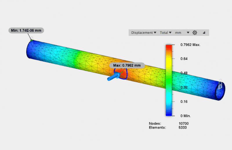

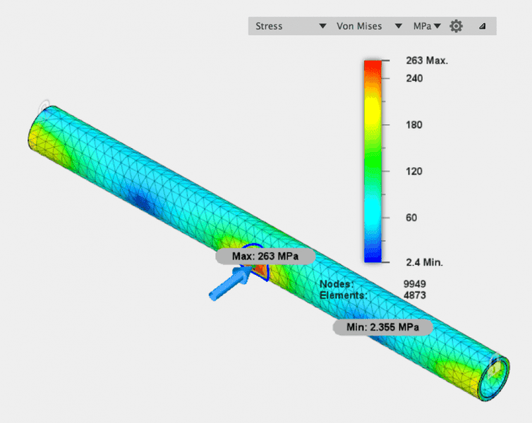

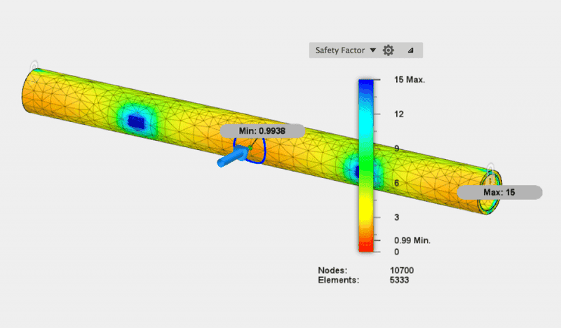

so i gave it shot - but i must be doing something dumb. the answer isn't making a lot of sense.
here are a couple of images from my FEA program. I'm using a 12" titanium pipe, and applying force to it in a 10mm radius.
i'm using "safety factor" to determine when a failure occurs (when it < 1 the material fails, and permanently deforms.)
10,000 N results in a minimum safety factor at the point of force of .49
6,000 N results in a minimum safety factor at the point of force of .83
5,000 N results in a minimum safety factor at the point of force of .99
4,000 N results in a minimum safety factor at the point of force of 1.2
so i figure at ~5,000 N we have a failure, and at > ~5,000 N we don't.
i also see the the FEA program shows that we have minuscule level of permanent displacement of 0.79mm.
using the formula Energy (KE) = 1/2 Force (F) * Deflection (x) i end up with:
KE = 1/2 * 5,000 * .00079 = 1.975 joules. so, that doesn't seem right.
what am i goofing up here?
I would make sure and run a mesh convergence study on your FEA model before trusting its numbers. This is where you increase the density of your mesh and see if the numbers change. If they change with a higher mesh density (especially stress), your model's result is being driven by some local effects near a geometry feature, or one of your boundary conditions.
Also, your mesh looks pretty coarse; I'd recommend that you should have 2-3 elements through the thickness of the pipe's wall.

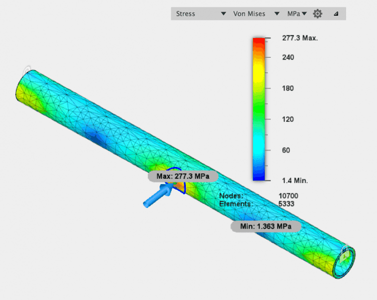

i've max'd out the elements on my FEA program, and it changed the numbers, but it didn't seem to change them much.
i'm still puzzled if maybe I've made an error in following the suggested formula, or perhaps there are limitation in my FEA program (autodesk fusion 360.)
here are shots showing the stress numbers from a fine mesh (the finest my app will let me go to) and a more coarse mesh.

What are your support conditions for the pipe? Is it fixed at the ends?
Also what is the pipe's wall thickness, diameter, and length?
12" length, 1" OD, .088" wall thickness.
it's fixed at both ends.

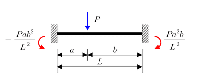

Keep in mind that fixing both ends of the pipe approximates it being welded between two infinitely stiff plates which cannot move. This results in some tension in the rod when bending. Does your analytical equation analysis take this into account?
The equation provided above is for a simply supported beam, so it's not quite the same as your FEA model. If you indeed want the model to have the ends of the beam fixed, then the equation set you should use are for a statically indeterminate beam.
The stiffness of your bar is 5000/0.00079 = 6.3e6 N/m
Compare with my approach. You have a single horizontal bar:
[tex]k_{hb} = \frac{48E_mI}{L^3}[/tex]
But this is for a simply supported beam (as @Mech_Engineer mentioned). For the 2 ends fixed the 48 must be replaced by 192 (It is stiffer).
[itex]E_m[/itex] is 200e9 Pa for steel (I assumed the material), [itex]I = \frac{\pi}{4}(r_o^4 - r_i^4)[/itex] is 6.3e-9 m4 for the tubing and [itex]L[/itex] is 0.3048 m. Therefore, [itex]k_{hb}[/itex] is 8.5e6 N/m, i.e. only 35% stiffer than what your FEA predicted. The displacement ([itex]x = \frac{F}{k_{hb}}[/itex]) and energy produced ([itex]\frac{F^2}{2k_{hb}}[/itex] or [itex]\frac{Fx}{2}[/itex]) are then 0.59 mm and 1.46 J, which all relate to your numbers.

The ≅ 5000 Newtons for the initial failure point is correct, but you are misreading the safety factor values. As the safety factor increases to 1 and above the allowable load decreases, not the reverse. The lower than 1 safety factor value is an indication of failure and as the safety factor increases to 1 and above (and the associated load values decrease) the risk of damage to the beam decreases.
With regard to the allowable low load and energy values, I am concerned about how you are applying your (point) load because in most real world applications the contact loads are spread over a finite area of the surface being struck or loaded. So if you are modeling your loading in very small contact area of your tubular beam; then, the amount of loading and energy required to imprint your and deform your beam in that small area is going to be very small as well. (Think of it as the effect of placing a pointed, or small end, punch against the side of the beam and hitting the punch with a hammer.) In most real world applications, impacts are not (point) loads but applied over a reasonably large area. At the same time, your analysis is revealing to you one of the weak points of thin wall tubular beams with side contact or impact loads because they are, in fact, when subjected to small area or lateral line loads vulnerable to imprinting and buckling unless reinforced in the area of the impact or applied loading.
With regard to the above beam analysis discussions, all of which are correct and applicable to the overall bending stresses and deflections for your beam; however, these standard beam equation analysis using a (point load) are acceptable for their purpose because they are only analyzing the overall beam bending stresses and deflections and not analyzing the beam at the point of contact for contact stresses and buckling effects that are a part of your FEA program analysis.
