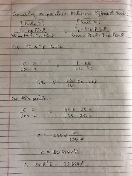

This is a detailed explanation on how to solve this problem and solve any problem based on temperature scale conversion. It's very easy. Hope it helps. I AM THE ONE WHO KNOCKS.
