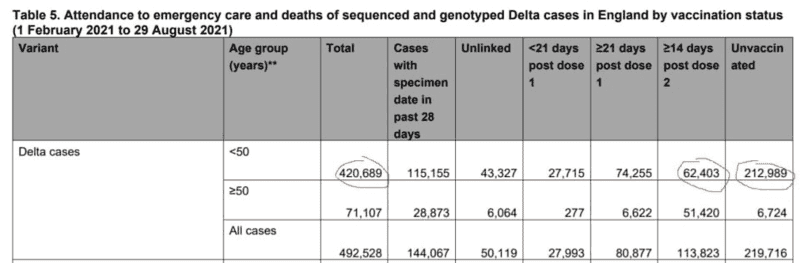

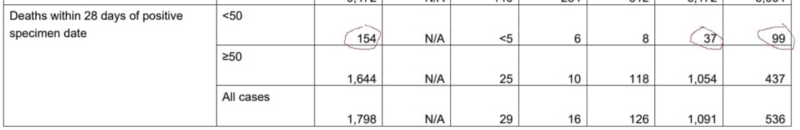

I have been trying to convince someone that it is wrong to compare the death percentages of two different populations (percentage of death of Covid-19 cases per category: vaccinated vs unvaccinated) in an uncontrolled setting (i.e. real-world data), and conclude that the Covid-19 vaccine does not work.
Can you guys help me out on the validity of this claim using Statistics?
So here is the much argued upon chart (2 screenshots of the same chart).
My questions are:
1. Is it valid to compare the percentages of death over the total number of covid-cases for ages <50 between these two groups: unvaccinated and vaccinated (see circled numbers in the table). That is death percentage of unvaccinated is 0.05%, while death percentage of vaccinated is 0.6%.
2. Which brings me to this next point. Based on 1, is it valid to say that the vaccine does not work?
Geez. I can't believe I am posting this on here. But yeah, Statistics is the way to go to save a friend.Source of data: https://assets.publishing.service.g...le/1014926/Technical_Briefing_22_21_09_02.pdf
Naively the % of deaths among vaccinated is greater than unvaxxed, however
A) does not specify other health conditions - likely the vaxxed admitted had other health issues- in the under 50 age group presumably vulnerable people got vaxxed at a higher rate
B) presumes they were actually vaccinated - did the NHS verify or was it just a question answered - sick people may be embarrassed to admit they did not get the vax and lie
C) The UK's vaccination rate is approaching 90%, so the vast majority of adults are vaccinated, the sample is biased - at some high vaccination rate (like in Israel) cases among vaxxed people will become the majority
Depends on what you mean by “work”. This shows that in the studied population the vaccine does not keep hospitalized patients out of the morgue on average. But it sheds no light on whether it keeps symptomatic patients out of the hospital, whether it keeps infected people from becoming symptomatic, or whether it keeps exposed people from becoming infected.
It also provides no information about the population or any co-morbidities. Failure to account for such things in an observational study means that the study isn’t reliable.
England has reached 88% vaccinated. With that in mind, your data seems to show that vaccination works well to keep people from needing emergency care since they are far fewer than 88%. The conclusion might be that if a vaccinated person needs emergency care he is in the same or greater danger of dying. That is a big 'if'.

No it is not, because there are many more vaccinated people than unvaccinated people. So you have to compare the rates of death between vaccinated and unvaccinated people, ie. compare [(vaccinated deaths)/(number of vaccinated people)] with [(unvaccinated deaths)/(number of unvaccinated people)]. These estimates are available in the Vaccine Surveillance report (p15), where the death rate among vaccinated people aged 70-79 is 9.2/100,000 and the death rate among unvaccinated people is 52.1/100,000, so one estimate of vaccine effectiveness is (1-9.2/52.1)x100% ~ 82%.
One factor that may make that number an underestimate is that many in the UK have been naturally infected, which also provides protection to the unvaccinated. There are other factors, and the report itself warns "In the context of very high vaccine coverage in the population, even with a highly effective vaccine, it is expected that a large proportion of cases, hospitalisations and deaths would occur in vaccinated individuals, simply because a larger proportion of the population are vaccinated than unvaccinated and no vaccine is 100% effective. This is especially true because vaccination has been prioritised in individuals who are more susceptible or more at risk of severe disease. Individuals in risk groups may also be more at risk of hospitalisation or death due to non-COVID-19 causes, and thus may be hospitalised or die with COVID-19 rather than because of COVID-19." However, one can see that even without correcting for those factors, vaccination reduces the risk of death by about 5 times for that age group.
With the proper corrections, the report estimates the vaccine gives about 91-98% protection against hospitalization caused by the Delta variant (Table 3, p8).
